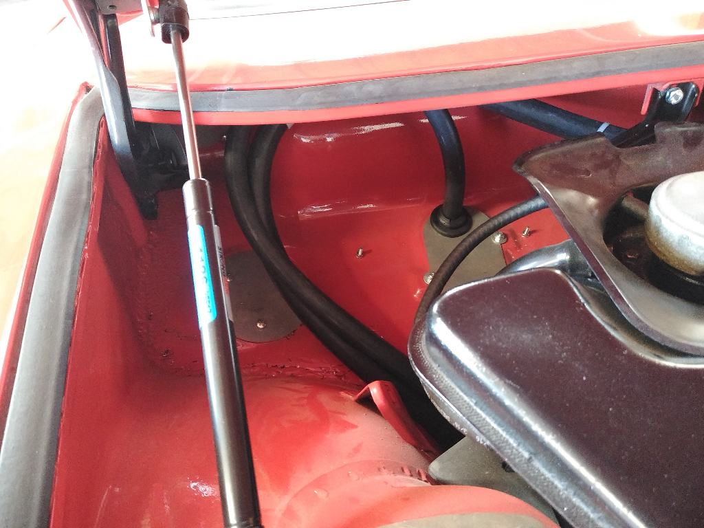

Condenser hoses go under and then up behind the tank. The #6 then goes down into the cab to connect to the evaporator. Pretty tight but kept everything tidy.

FL 000   Condenser hoses go under and then up behind the ta...   Apr 18 2020, 09:15 PM
FL 000   Here's a pic of the hose going to the evap. It...   Apr 18 2020, 09:24 PM
