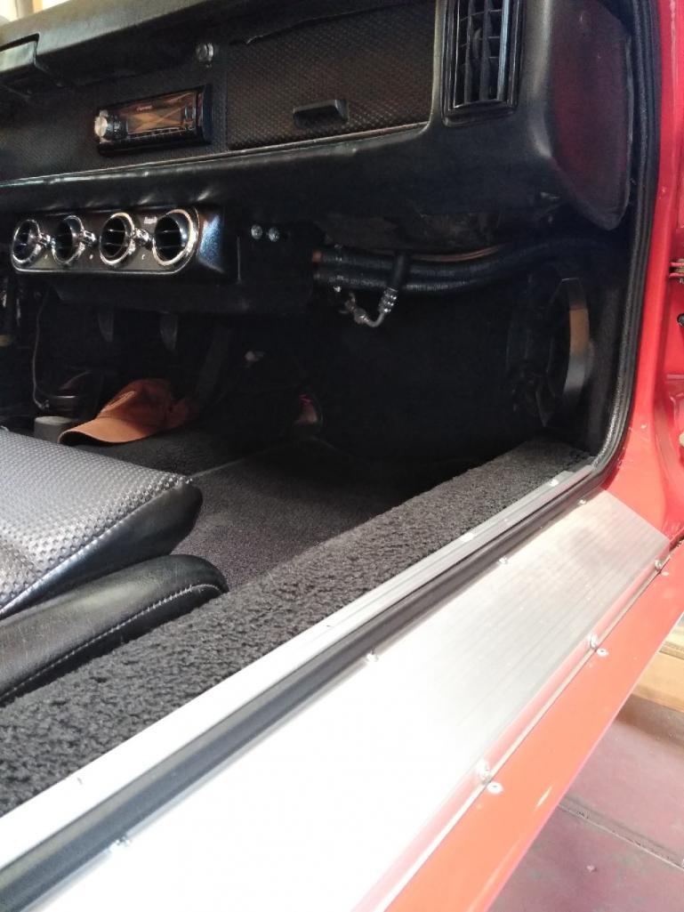

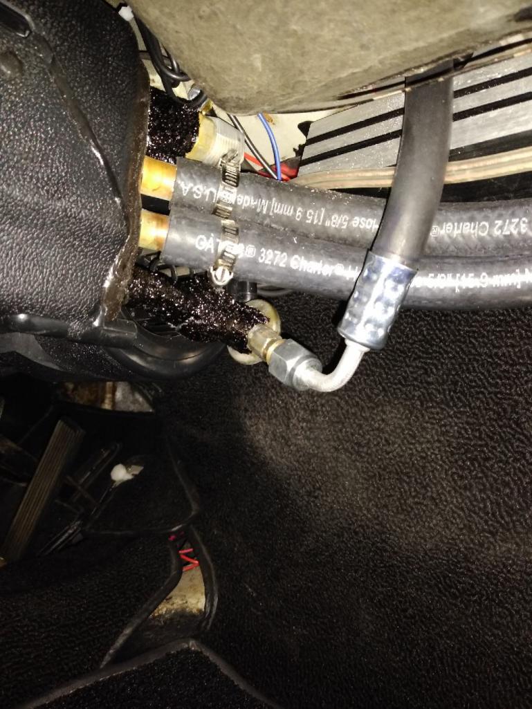

Here's a pic of the hose going to the evap. It's high enough where your feet clear it when seated, but low enough that I am concerned someone my break it some point. I'll probably try to make a cover to give it some protection.
That's it for today. May be able to get the compressor mounted and final connections made tomorrow. (IMG:style_emoticons/default/yellowsleep[1].gif)
