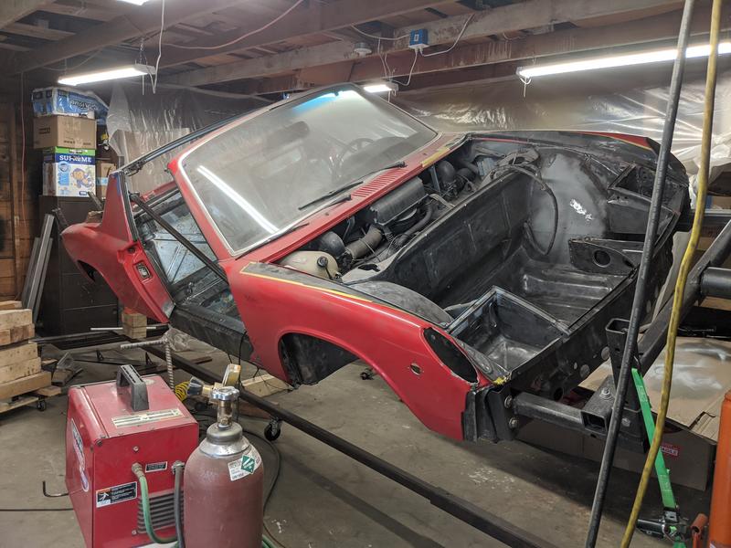

QUOTE(Tdskip @ Apr 19 2020, 08:04 AM) *
Thanks for the updates, making great progress!
(Blocks of wood supporting the car make me nervous still)
It's on a rotisserie, the blocks were to keep it flat.
