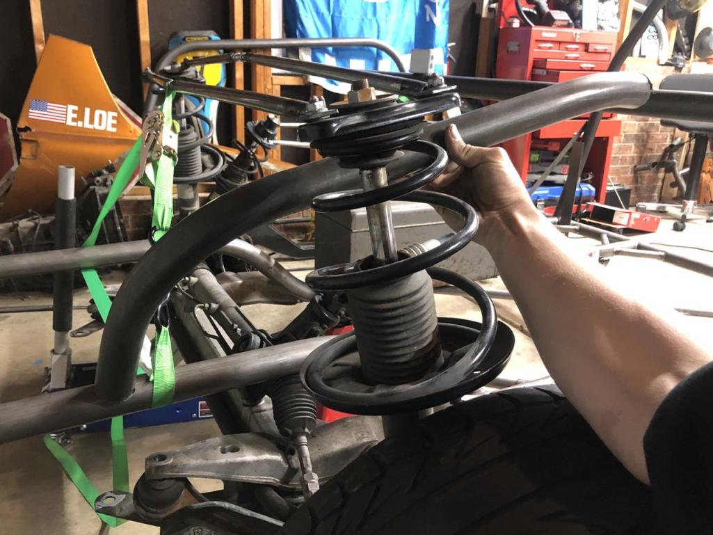

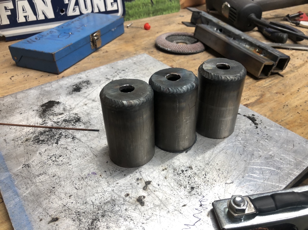

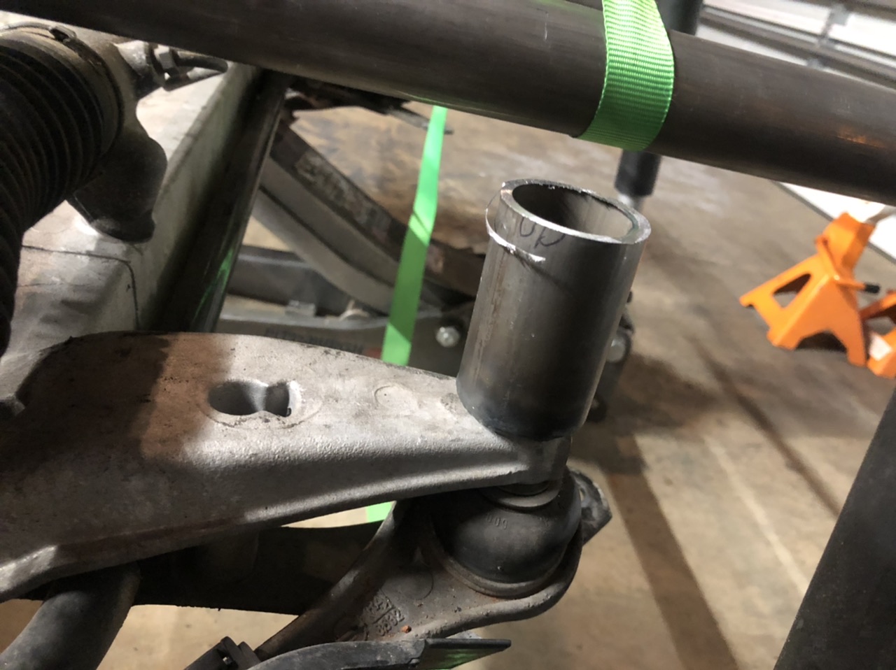

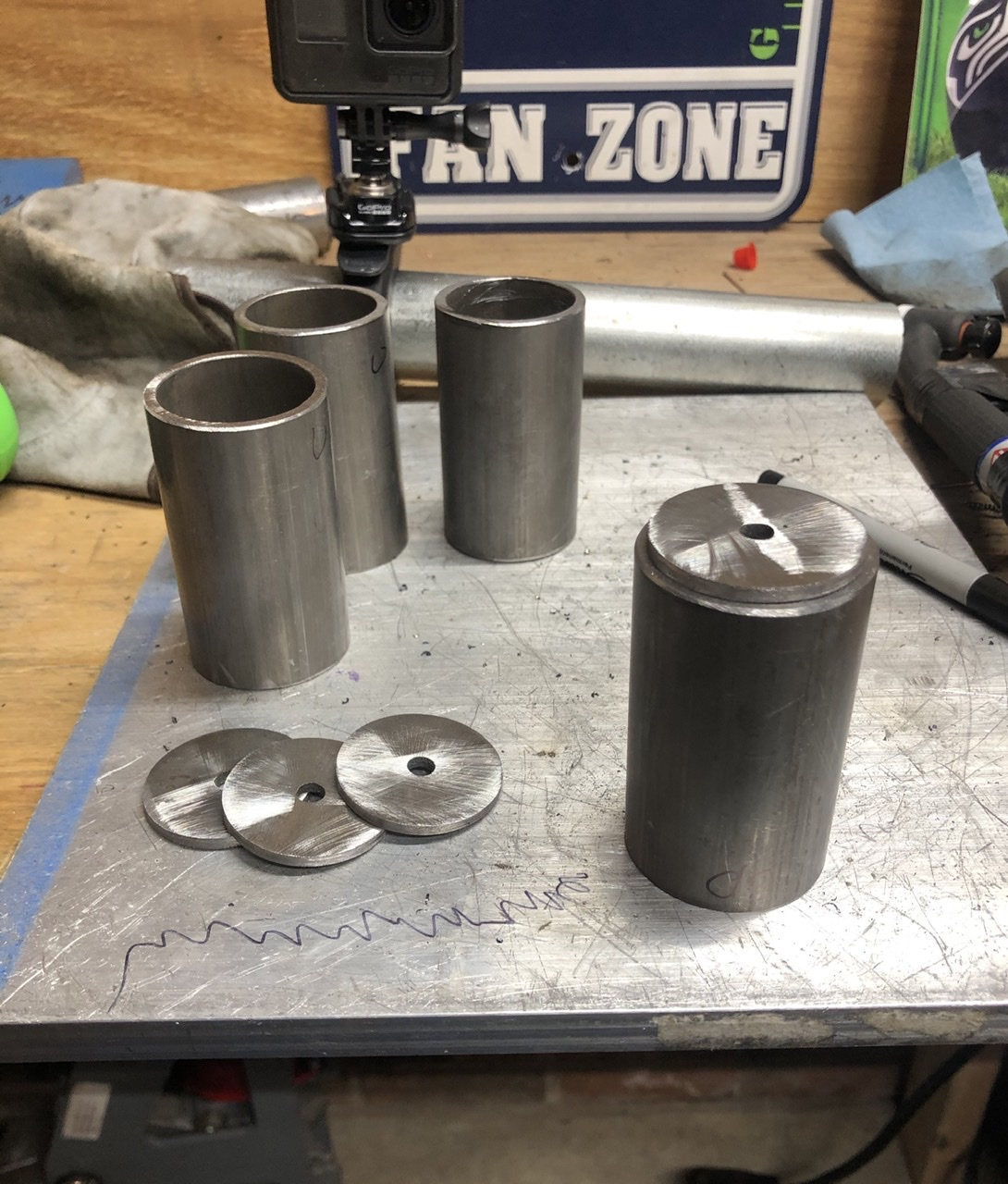

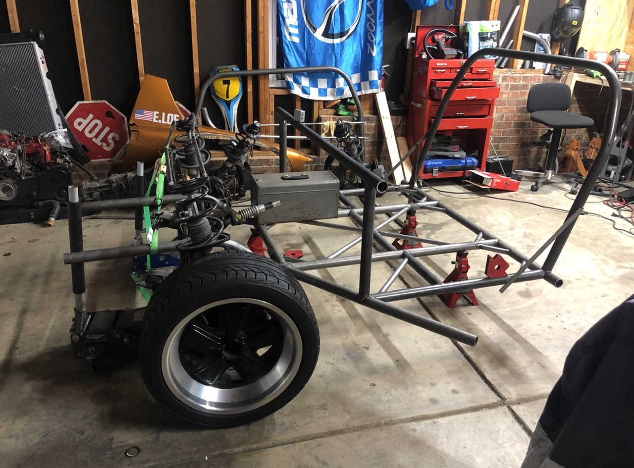

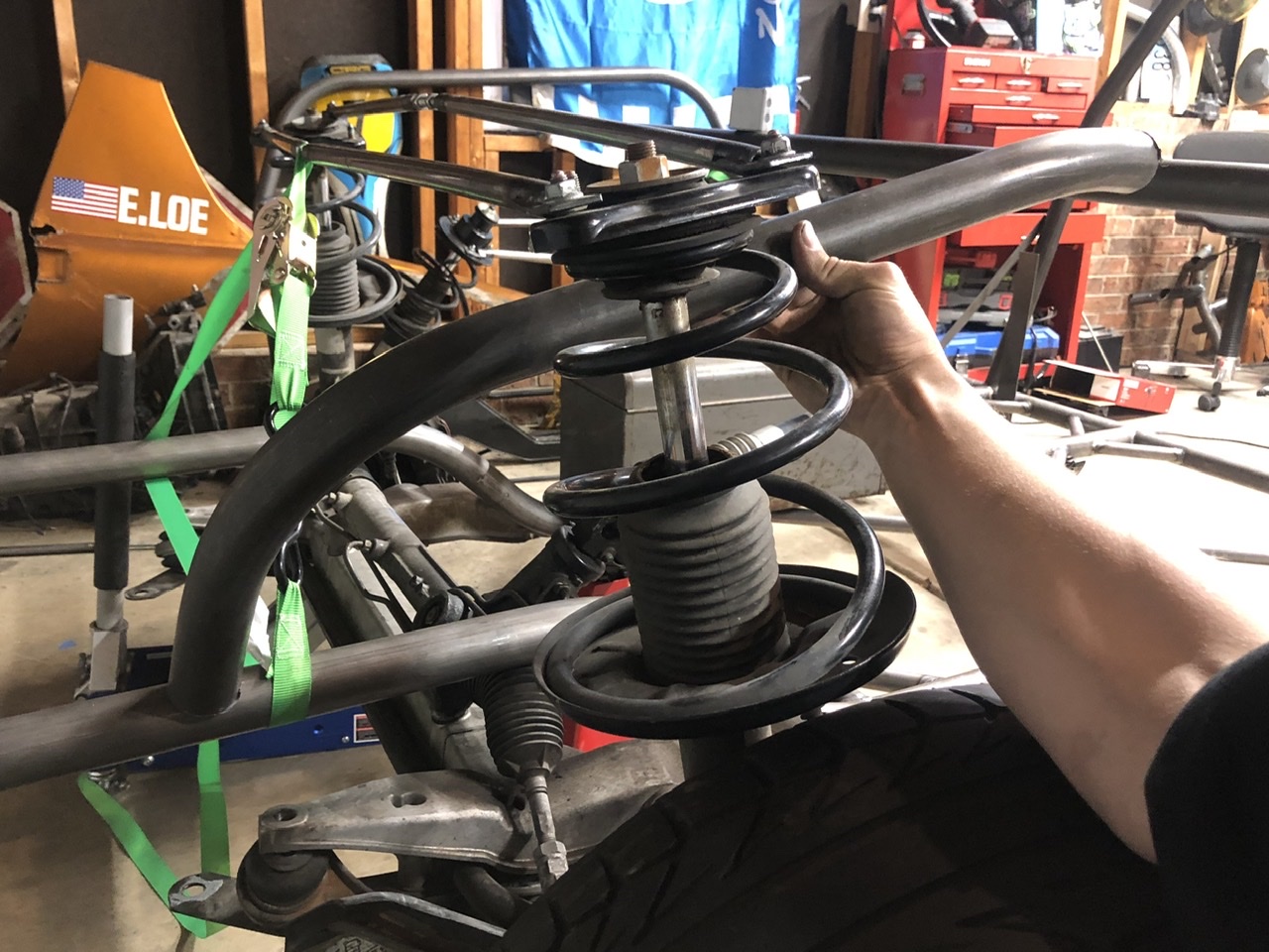

Ok update: I was out of town for a couple days and was nearly dead from exhaustion for the next day and a half. So progress stopped for a bit, but now ive made some good progress! I built some cups to mount the subframes, they came out good but i ran out of gas almost immediately afterward. Then i put the subframe up in place and found my guess on the bars that could run into the wheels dont! and the mounting seems easy for the subframe in the front. I also took a scrap bar from a failed main hoop and it looks pretty good to me. (IMG:style_emoticons/default/smash.gif) Tomorrow im gonna take the struts off because they’re being a pain in the ass and it will make it considerably easier to deal with.
Really obscure question does anyone have a boxster they can jack up to tell me the control arm angle in full droop? If not ill have to figure it out somehow, i have the angle while loaded on the ground.
Subframe cups:
Scrap Bar strut tower:
With a wheel on:
