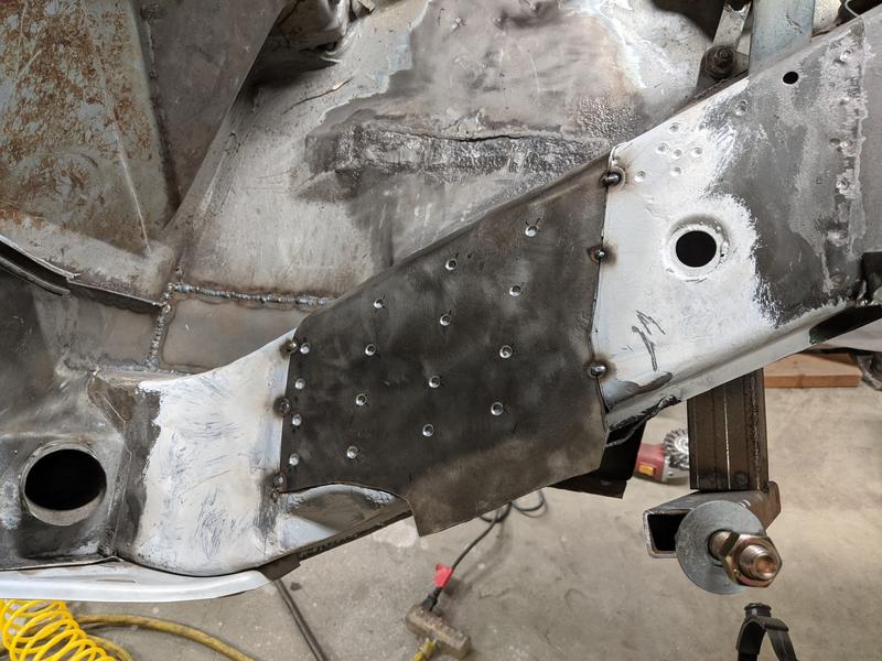

I decided to cut out the piece of the long behind the motor bar mount after all. There were two spot where the metal was very thin (see picture above) and I wanted to be sure it was sound. It turns out that there was no rust behind the outer skin so an overlay piece probably would have been fine, but having lots of solid metal made it very easy to weld the patch in and eliminate the soft spots for good.
Area behind the outer skin, no rust at all:
(IMG:http://www.914world.com/bbs2/uploads_offsite/i.imgur.com-23821-1587446174.1.jpg)

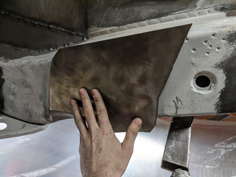

Patch being fit:
(IMG:http://www.914world.com/bbs2/uploads_offsite/i.imgur.com-23821-1587446175.2.jpg)

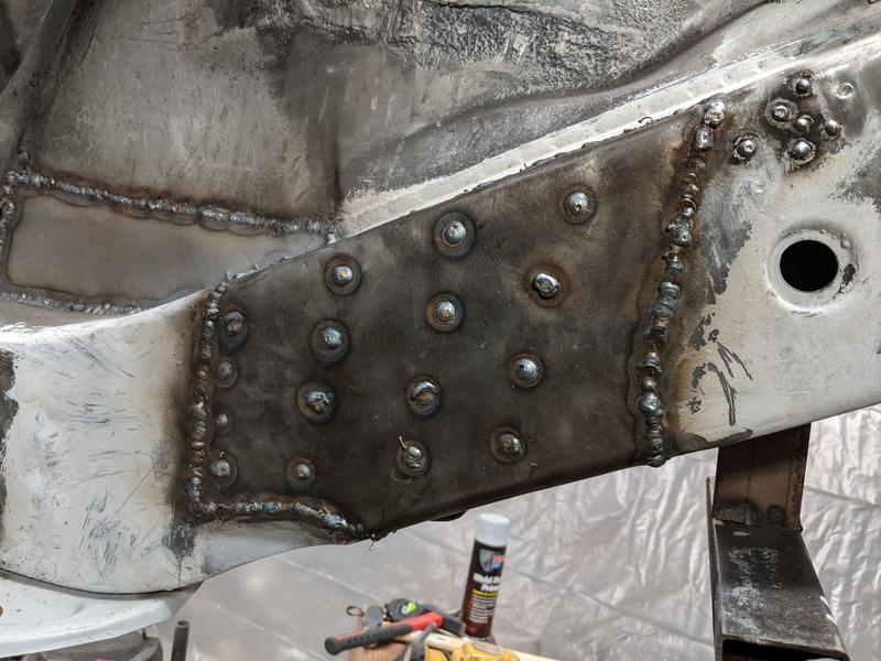

These holes are a bit small, I opened them up for better welding:
(IMG:http://www.914world.com/bbs2/uploads_offsite/i.imgur.com-23821-1587446175.3.jpg)
Ready to grind off the welds:
(IMG:http://www.914world.com/bbs2/uploads_offsite/i.imgur.com-23821-1587446175.4.jpg)
