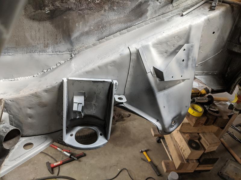

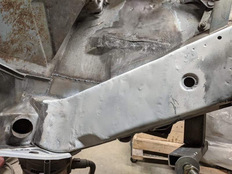

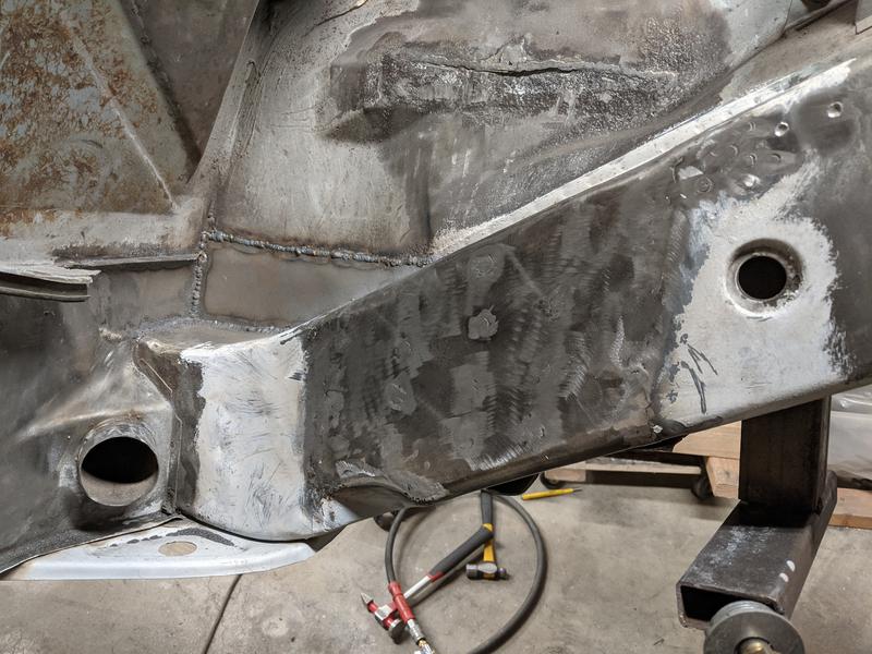

Getting closer, welded the engine bar mount and suspension console on today. The suspension console took forever to position because it didn't fit well when positioned as the previous one had been (1/4 inch gap on the bottom rear). I used the locator bracket but measured as well. I mounted the swing arm after to see how it fit and everything seems to be aligned. Definitely not my favorite part of this project, will be a relief after the car is running and aligned.
Welds ground down:
(IMG:http://www.914world.com/bbs2/uploads_offsite/i.imgur.com-23821-1587526591.1.jpg)

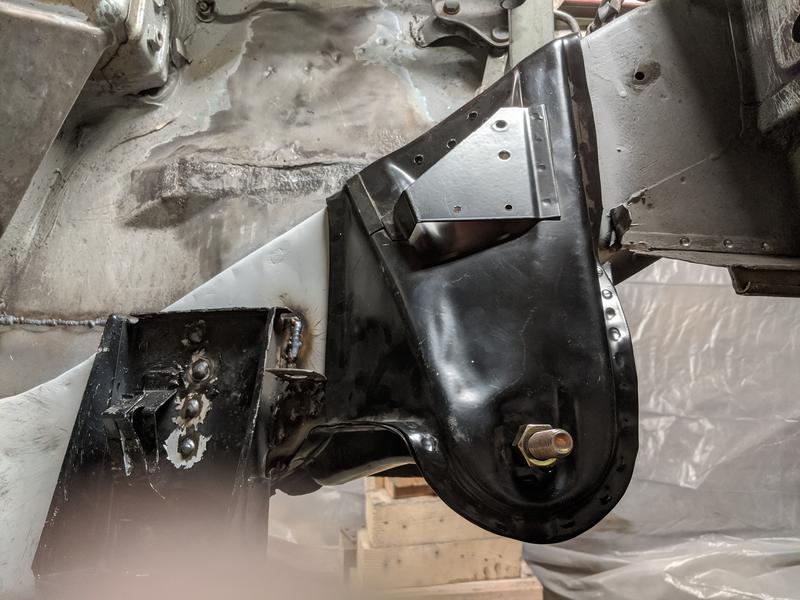

Weld through primer:
(IMG:http://www.914world.com/bbs2/uploads_offsite/i.imgur.com-23821-1587526592.2.jpg)
Test fit:
(IMG:http://www.914world.com/bbs2/uploads_offsite/i.imgur.com-23821-1587526592.3.jpg)
Mostly done:
(IMG:http://www.914world.com/bbs2/uploads_offsite/i.imgur.com-23821-1587526592.4.jpg)
