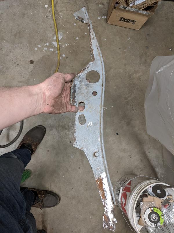

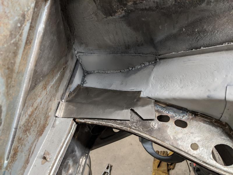

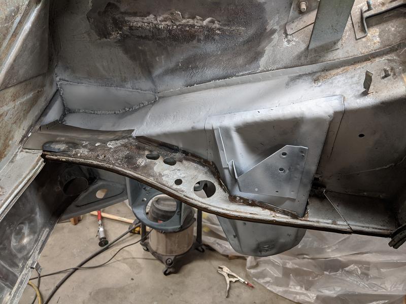

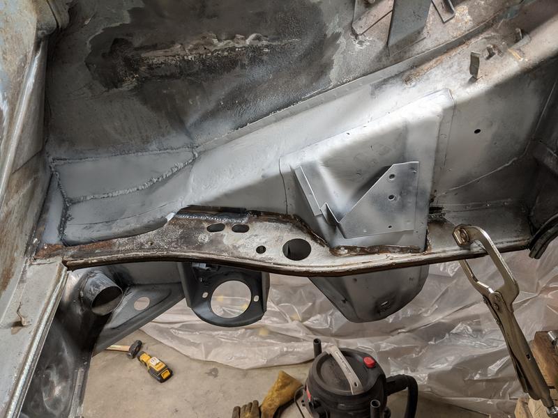

Finished some minor weld grinding and started rebuilding the engine shelf. I'm going to add a drain hole and weld it in tomorrow.
