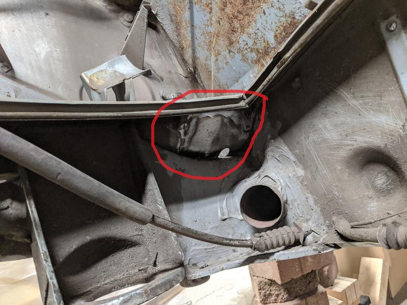

Passenger long, looks fairly solid from the outside. The hole is where I used a cheap endoscope to look at the inside (lots of rust).

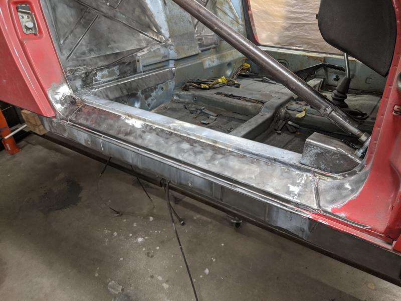

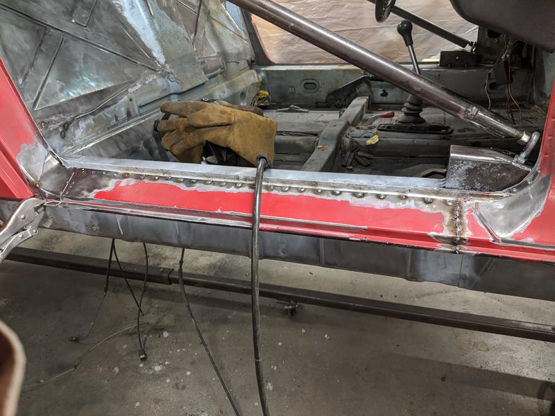

Reattached the passenger door sill and repaired the driver's side engine shelf (drain plug had clogged).
(IMG:http://www.914world.com/bbs2/uploads_offsite/i.imgur.com-23821-1587743840.1.jpg)
(IMG:http://www.914world.com/bbs2/uploads_offsite/i.imgur.com-23821-1587743840.2.jpg)
(IMG:http://www.914world.com/bbs2/uploads_offsite/i.imgur.com-23821-1587743840.3.jpg)
