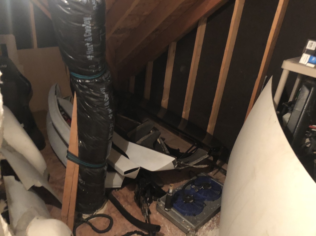

I dont have many parts left, I took all the good parts off sold what i could and kept what i needed.

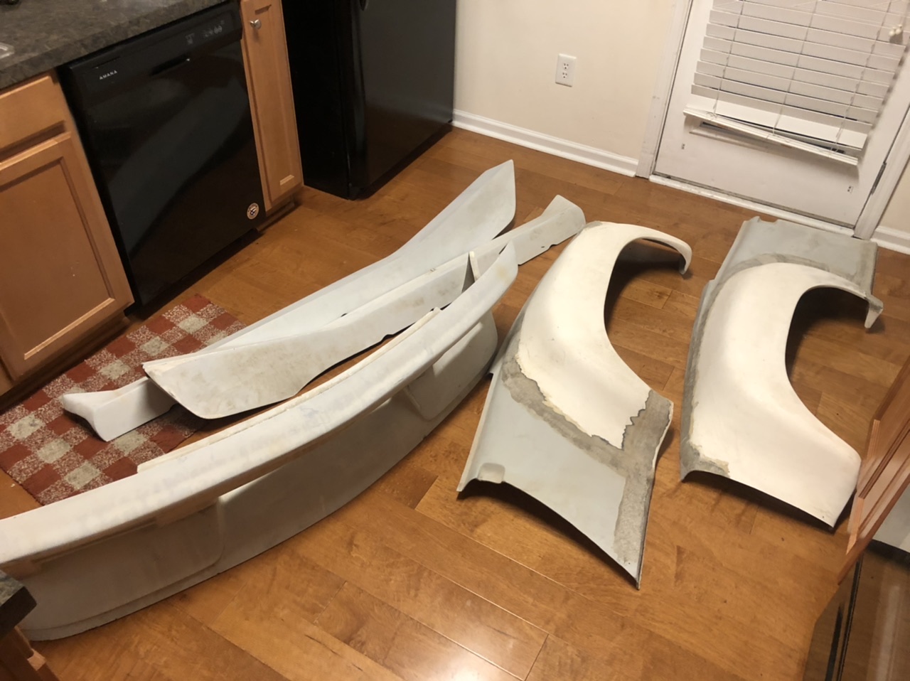

I finally got the fiberglass ive been waiting for since before the corona outbreak. I picked it up from greyhound today (side note: dont ever ship greyhound, you pick up your porsche parts from a gas station in the ghetto)
This was the biggest box ive ever received, i WAS gonna pick it up with my kei car, Honda beat but i listened to reason and took a volvo.... wise choice.
Everything is a bit rough.. especially the fenders but i can make it work. The front bumper is decent enough to make me happy, and i knew the side skirts were wrong buying this stuff but oh well. I think they’re sheridan skirts if anyone needs them let me know, they are in good condition. Add it to the fiberglass stockpile in my attic.
