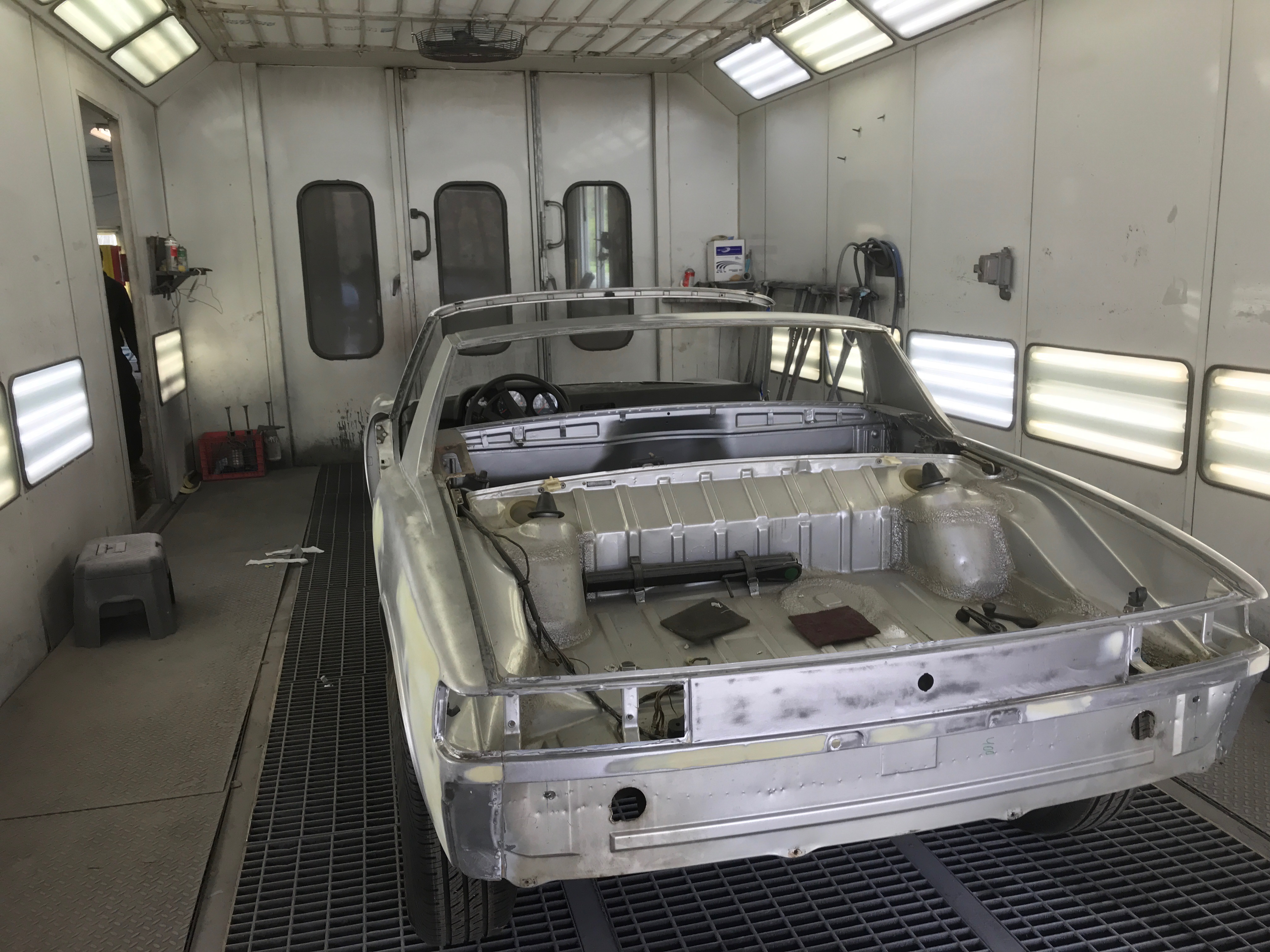

Hello folks!
I’m in the planning phase of painting my teener.
The car is very original but it has a dull non original top coat (silver),
hence I’m contemplating how far I shall disassemble the car.
I’m planning to go down to bare metal for the new paint. However, the
inside of the body, trunk’s inside and door seals have great looking original
paint that I want to preserve.
What’s the forums experience/verdict?
Paint assembled or build stands for the doors and remove trunks to
paint them off the body?
Thanks!
PS: i do plan on removing the windshield.

draganc   Found a competent and trustworthy body/paint shop ...   Mar 31 2020, 08:52 PM
draganc   PS: went down to bare metal to be positively surpr...   Mar 31 2020, 08:53 PM
draganc   ...   Mar 31 2020, 09:02 PM

draganc   More good news! :Qarl:   Apr 3 2020, 09:26 PM

draganc   And we are progressing:   Apr 25 2020, 08:08 AM
draganc   RE: How far to disassemble a 914 for new paint?   Apr 25 2020, 08:09 AM
draganc   What’s the group’s take in finishing or seam â...   Apr 25 2020, 08:24 AM
