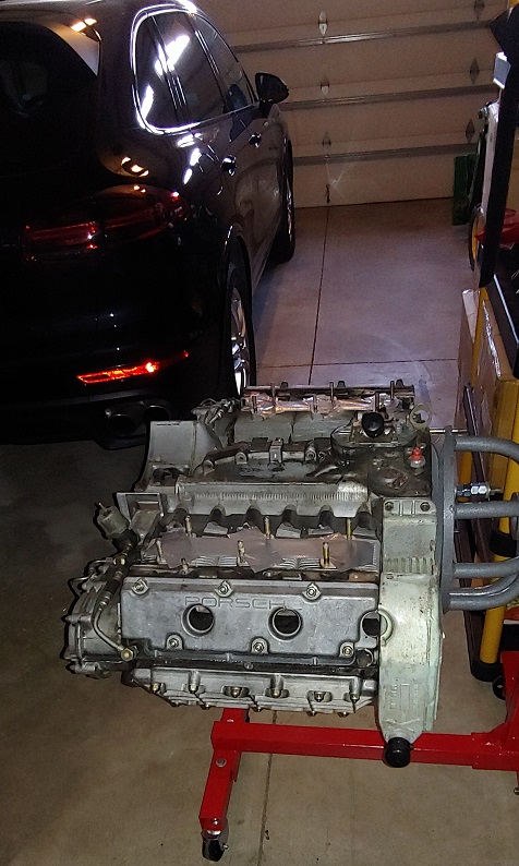

With this covid thing going around it has set my project back. I had plans to have the chassis blasted and epoxy primed before I started cutting into it. The blaster emailed me and said per rules under the NY PAUSE act that my project is not essential and he couldn't do it until the state relaxed the rules. So now it's a waiting game there. I can do a few other things on the chassis before it goes. Got the new to me 3.2 in and started working on that. Apart she comes. Going with a 3.4 Mahle MS p/c's while doing the rebuild. Also in the works is a late model 3.2 915 with a Bott 916 shift kit. Stay tuned kids as I'll be working away when I can.

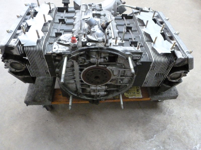

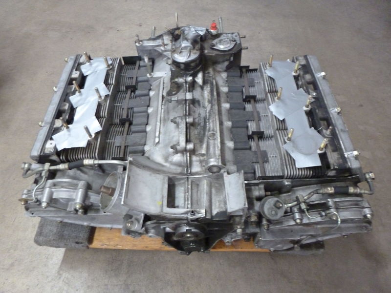

Luke M   Started the tear down on the 3.2. I'm gonna re...   May 1 2020, 09:16 AM
Mark Henry   For the Supertec head studs you'll need a thre...   May 1 2020, 10:49 AM
mepstein   I removed studs from about 25 engine cases when I ...   May 1 2020, 11:31 AM
Luke M   Got the head studs all off without any issues.. G...   May 2 2020, 02:47 PM
