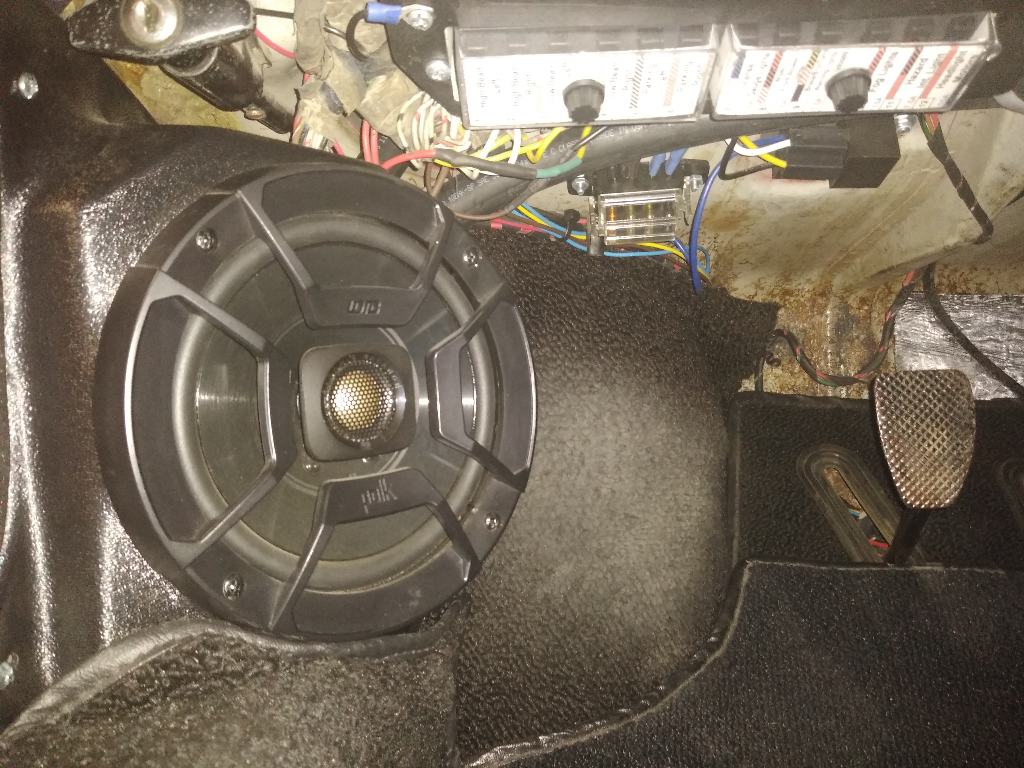

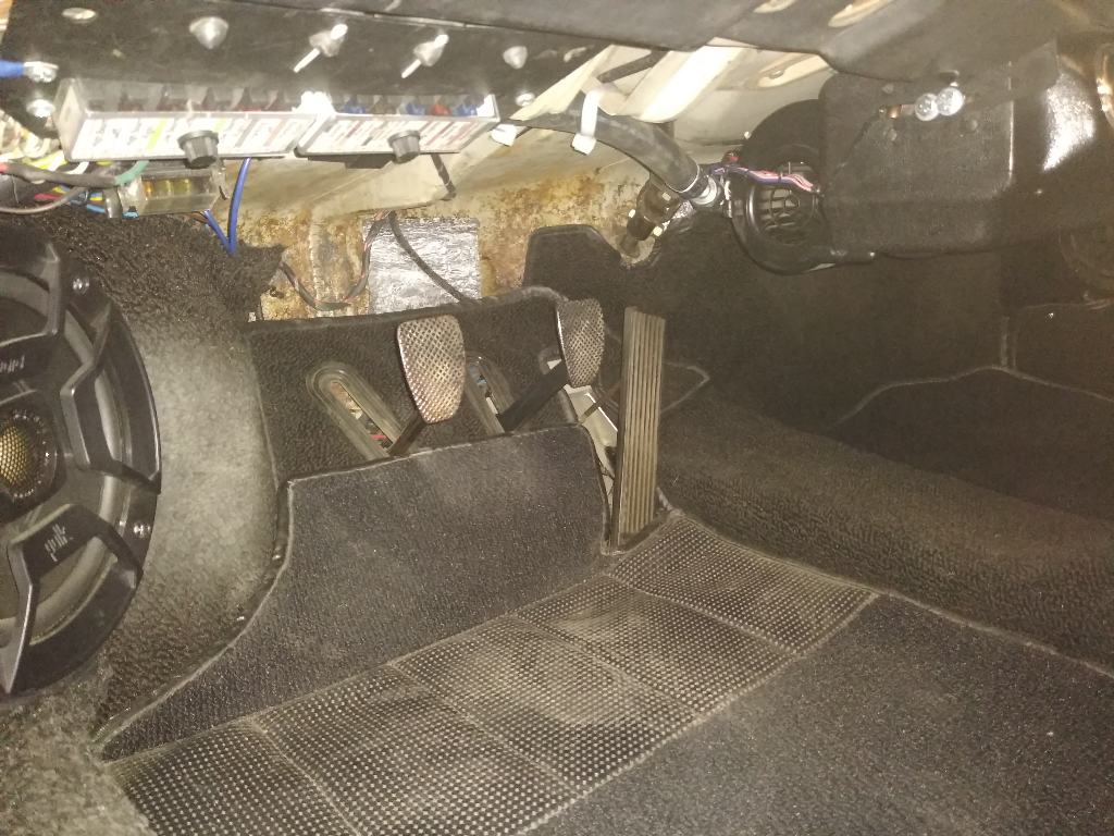

FL 000   Inside the cabin I started by removing the metal g...   Oct 18 2020, 07:29 PM
