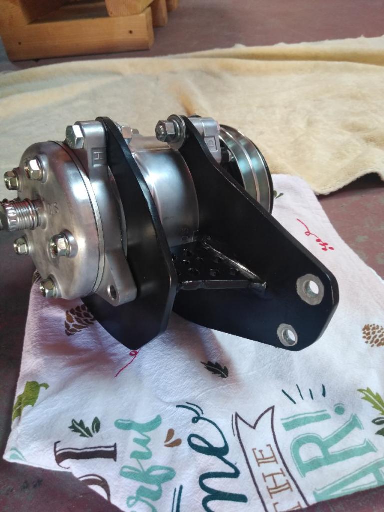

Then it was working on the business end. Here is the Sanden compressor with the mount finished and the new back on it for the rear hose connections.
I realized after I painted it that the compressor needs to ground through the mount for the clutch, hence the attempt at removing paint in a circular fashion. This is a case of function over form (IMG:style_emoticons/default/lol-2.gif)
