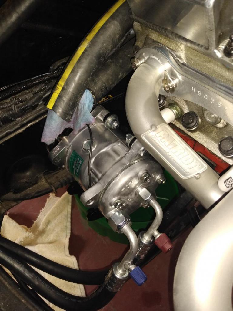

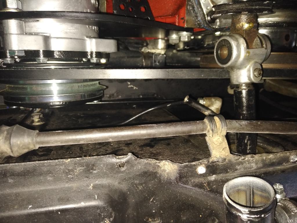

FL 000   Got some more work done the past couple weekends. ...   Apr 27 2020, 09:12 PM
FL 000   Then it was working on the business end. Here is t...   Apr 27 2020, 09:20 PM

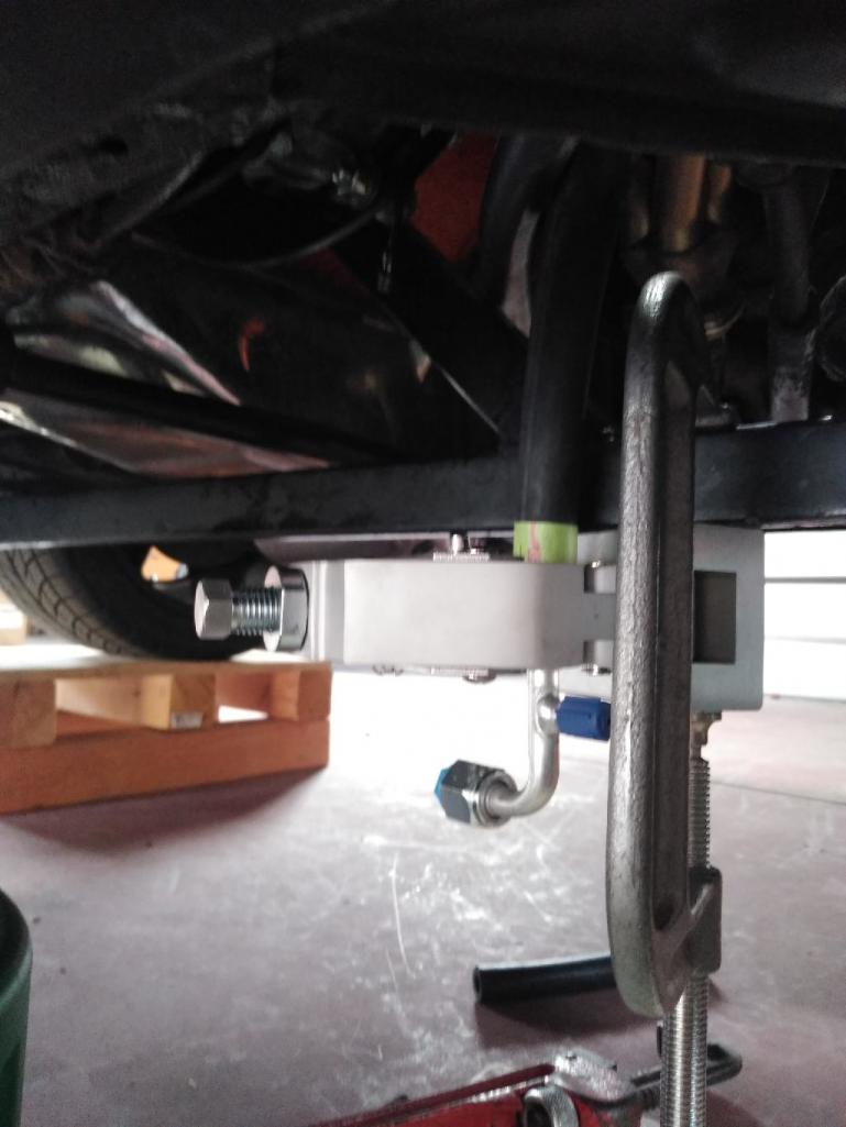

FL 000   Crimping the hose connections was a bit of a pain ...   Apr 27 2020, 09:26 PM
FL 000   After all that work I was definitely sweating the ...   Apr 27 2020, 09:42 PM
