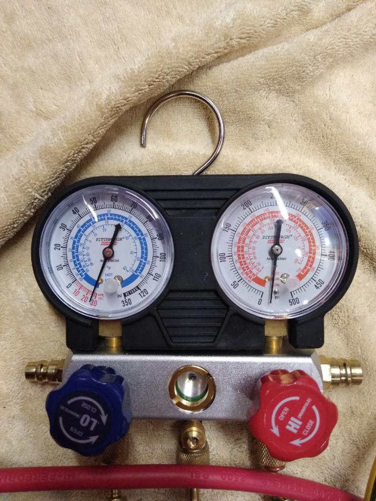

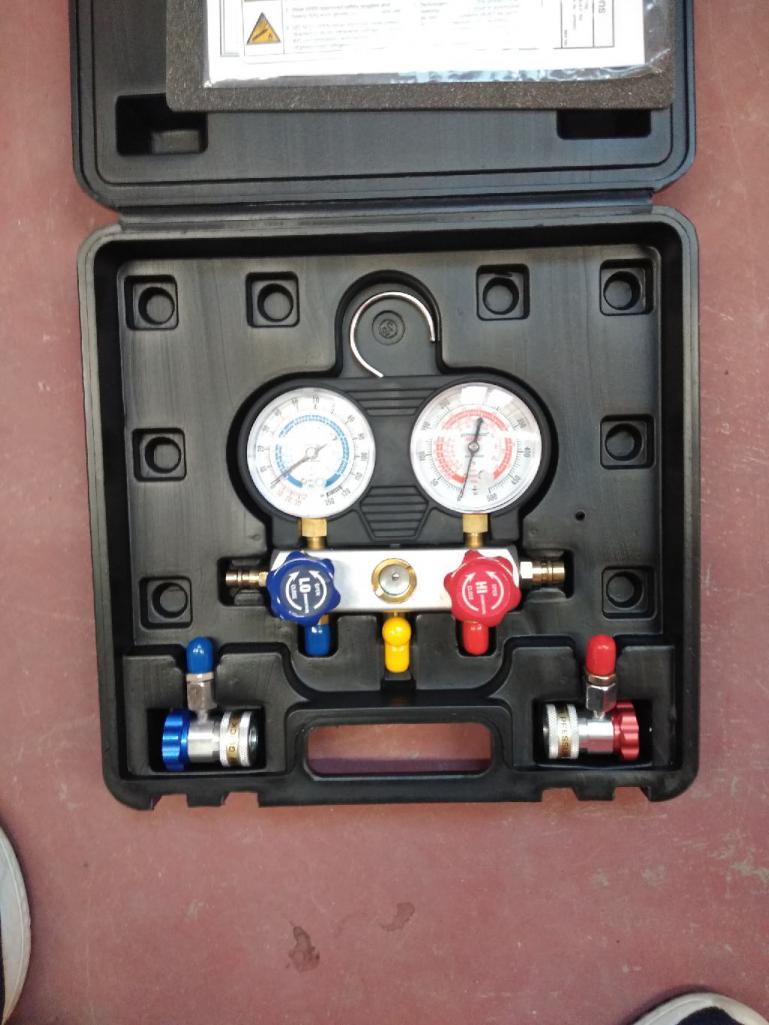

After all that work I was definitely sweating the vacuum test. I took my time on everything but there are so many places a leak could exist. I bought a new hose kit from Harbor Freight (big spender) to replace my old one that had bad hoses.
I connected and drew some vacuum, sealed the valve, turned off the pump, and watched the system slowly lose vacuum (IMG:style_emoticons/default/blink.gif) WTF. Walked away and slept on it for the night. The next day I thought maybe, just made be it was the HF hose kit and not all my custom work (cocky I know). After some tests sure enough the new quick disconnect couplers that attach to the high and low pressure ports were bad. Luckily my old ones still worked, so on they went and to my surprise it held pressure! Around 26 inches of vacuum after letting it rest for 45 minutes.
