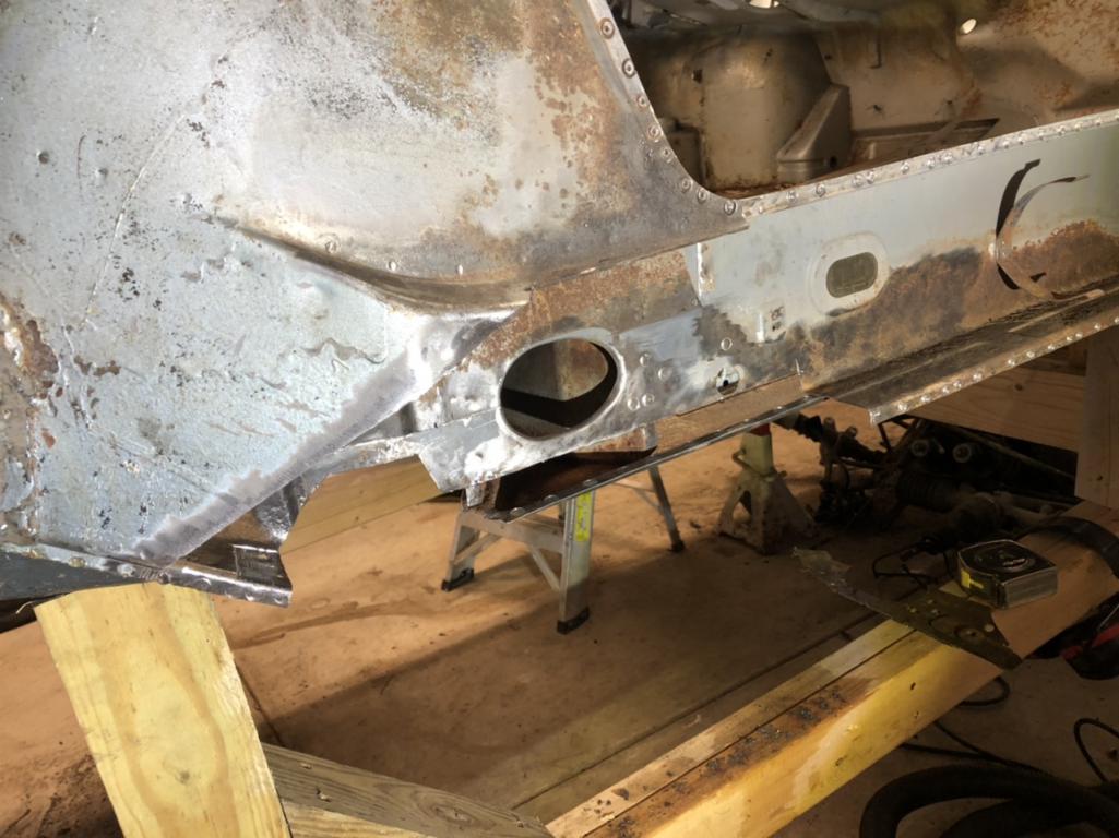

Pulled my rocker covers today to inspect for rot. Unfortunately I found significant rust on both jack points and the driver’s side long has a good size rust hole. I’m going to cut and patch the bad spots in the longs, but I’m trying to avoid a complete resto right now and I don’t want to get into exterior bodywork. The rear fenders are in pretty good shape but they seem to block access to the top flange of the jack point plate. Does anyone know if the jack points can be replaced correctly without cutting out a lower portion of the rear fender?

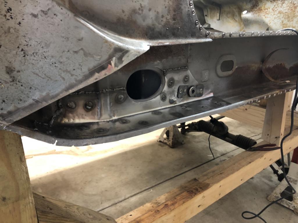

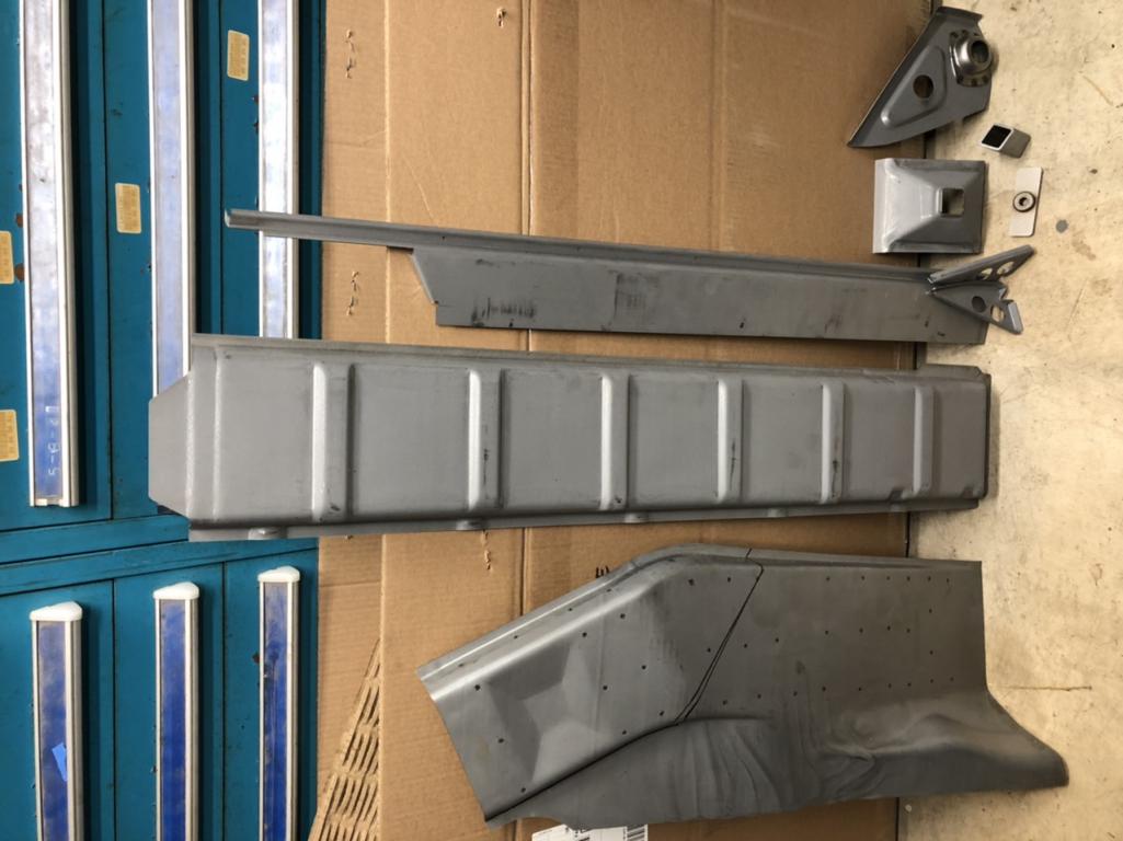

I’ve been chipping away at this project over the past couple of weeks and have made some progress on the passenger side repairs. As with any project like this, there has been considerable scope growth... one thing I am now considering is the addition of a inner long stiffener kit from Mad Dog Motorsports. I figure, since I’m here, now is the right time to do this... the question I have for all of you is, when should I install the stiffeners? Right now, I am just about ready to close up the passenger side long with the new inner rocker panel from RD. Before I do this, I want to coat the inside of the long with something for rust prevention. If I weld on a longitudinal stiffener after I coat the inside, some of the coating will burn off, but if I install the stiffener before I close up the long, I’m worried about warpage. Which is the lesser of the two evils? Anyone have any thoughts?

IronHillRestorations   You'll probably have to cut a section off the ...   Mar 10 2020, 04:44 PM
dlee6204   It is possible to replace the points without cutti...   Mar 10 2020, 05:38 PM
flyer86d   I’ve done it by cutting out the lower couple of ...   Mar 10 2020, 05:59 PM
Superhawk996   Uh, what what do you intend to weld to? Can’t w...   Mar 10 2020, 07:07 PM
bbrock   Yeah.... I'm afraid you are beyond being able ...   Mar 10 2020, 07:13 PM

Lilchopshop   Peeled back some more of the outer long so I could...   Mar 21 2020, 04:08 PM

Lilchopshop   Finally got the passenger side long closed up and ...   May 16 2020, 10:21 AM
Lilchopshop   Got the sill triangles installed today. Had the s...   May 18 2020, 10:54 PM
