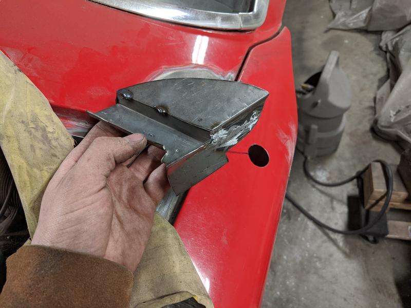

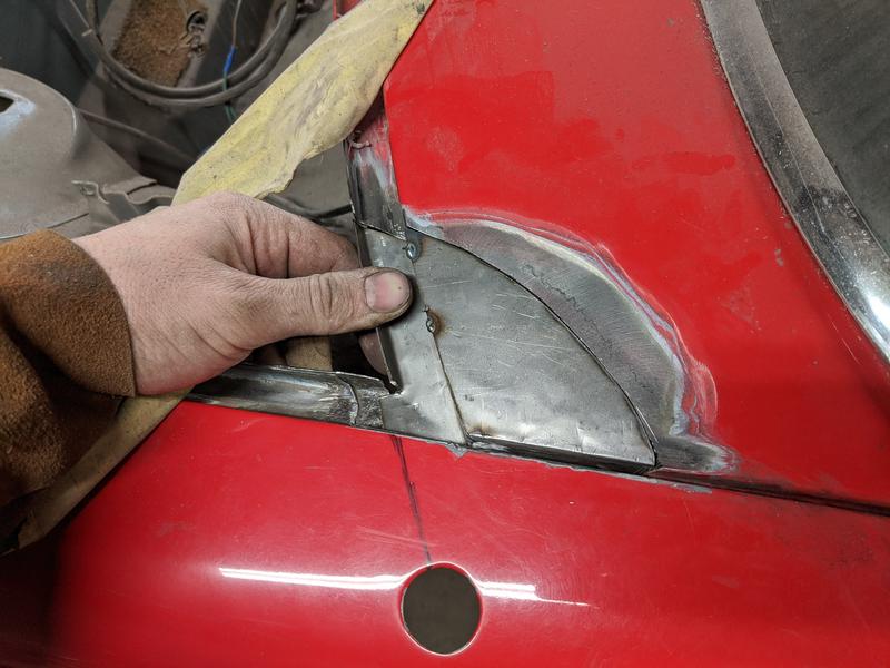

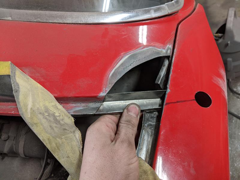

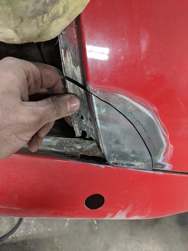

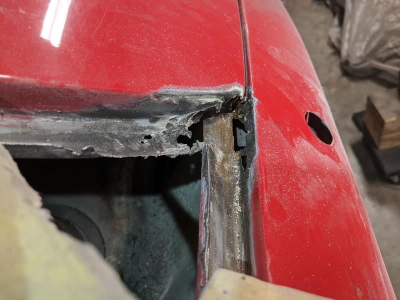

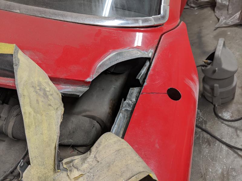

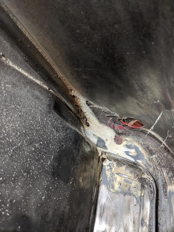

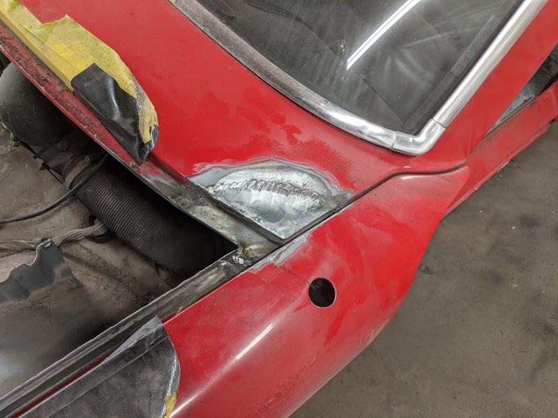

I've been cleaning off the bottom of the car to get it ready for epoxy primer. Unfortunately, cleaning out the inside of the driver's wheel well exposed some rust and a fiberglass repair of the trunk seal channel. I was going to leave this when I painted the body so as to not disturb the paint, but it will just have to be a bit ugly until then.
Rust, freaking rust:
(IMG:http://www.914world.com/bbs2/uploads_offsite/i.imgur.com-23821-1588127822.1.jpg)
There's the rust:
(IMG:http://www.914world.com/bbs2/uploads_offsite/i.imgur.com-23821-1588127822.2.jpg)
Cut it out:
(IMG:http://www.914world.com/bbs2/uploads_offsite/i.imgur.com-23821-1588127822.3.jpg)
Cleaned up:
(IMG:http://www.914world.com/bbs2/uploads_offsite/i.imgur.com-23821-1588127822.4.jpg)
Make stuff that looks like the stuff you cut out:
(IMG:http://www.914world.com/bbs2/uploads_offsite/i.imgur.com-23821-1588127822.5.jpg)
That looks similar:
(IMG:http://www.914world.com/bbs2/uploads_offsite/i.imgur.com-23821-1588127822.6.jpg)
Time to spend way too much time welding it in:
(IMG:http://www.914world.com/bbs2/uploads_offsite/i.imgur.com-23821-1588127822.7.jpg)
Solid, but ugly now until paint:
(IMG:http://www.914world.com/bbs2/uploads_offsite/i.imgur.com-23821-1588266799.1.jpg)
