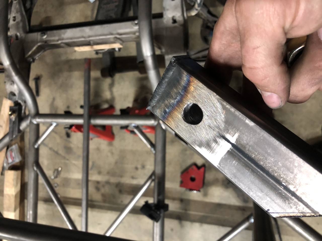

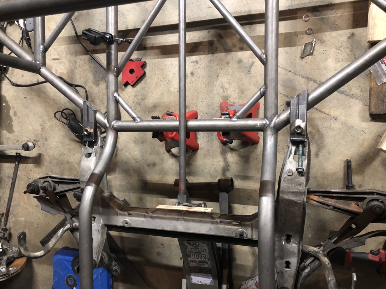

I was delayed a few days because i was waiting for bolts but im back at least for a little. I measured and measured again until i got the subframe nice and square so i could make decent lines to cut into my chassis.

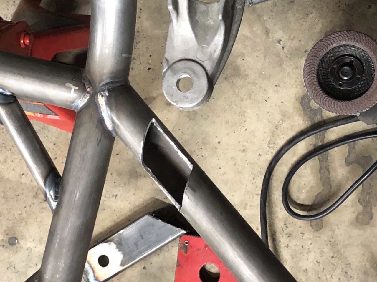

QUOTE(tazz9924 @ Apr 28 2020, 10:21 PM) *
What's this holding? If it's seeing any real load and not heavily gusseted you're likely going to rip the tube in the HAZ outside of the weld. BTDT. Sometimes gussets don't even do too much.
The welds look nice! (IMG:style_emoticons/default/first.gif)
I know you're going along a pretty good clip but below are some pro-tips*:
1) Get a second regulator and purge the ID of the tube frame when you full weld it. Quality will be much higher.
2) Clean the inside of the tubing with a pipe cleaner.
3) Drywall mesh does a really good job of cleaning mill scale off without loading up. A quick pass of the wire brush in one direction afterwards takes care of the rest.
4) For any coped tubes going into a tube without air connection (like your gussets), drill a small hole so 1) gases expanding inside don't cause your pool to blow out at you near closing the weld and 2) you can purge.
5) If you use 4130 or any other high carbon steel, be sure to normalize the weld HAZ to keep it from cracking under use. You can do this with a torch (instructions in Engineer to Win IIRC).
*Not a pro welder, but I've welded 5? (can't remember the full count now (IMG:style_emoticons/default/laugh.gif)) full tube framed formula cars and a bunch of semi-tubed cars.
