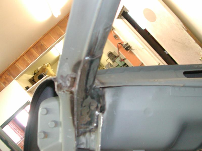

Troy put the A-Pillar mod on Gint's car. Came out awesome. These things crack a-pillars, especially when autocrossed or raced.
When I restored my 911 the a-pillars were cracked. The factory did the reinforcement to prevent cracking. A-pillars are weak, weak, weak.
Here's a couple of pictures that Andy came over and took... (IMG:style_emoticons/default/laugh.gif) (actually, the camera was pointed directly at the light so it didn't like to focus properly.)

JOHNMAN   You guys surely jest.... The A-pillar weak. Plea...   Dec 13 2004, 11:43 PM
Brett W   Yes I have cut the windshield off. The windshield...   Dec 14 2004, 12:17 AM

Brett W   It doesn't. What that patch does is, connect ...   Dec 14 2004, 01:18 AM
Mueller   looking at the pictures of the cracked windshield ...   Dec 14 2004, 10:57 AM

Eric_Shea   need more visual proof?   Dec 14 2004, 11:20 AM
Brett W   The problem with the 914 chassis is there are way ...   Dec 14 2004, 12:16 PM
