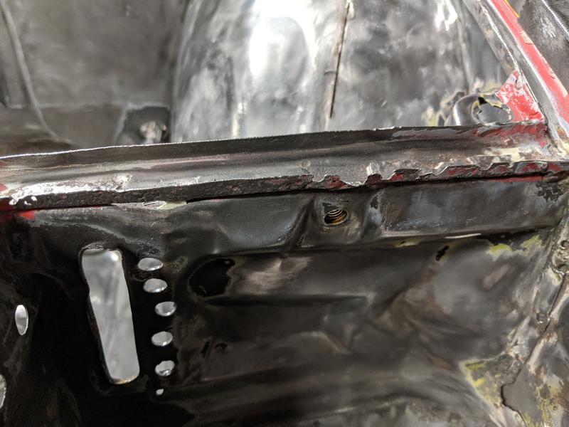

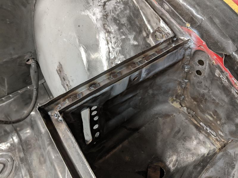

Spending way too much time cleaning up random bits and pieces of the project. The frunk seal channel was rusted away in a few places so I added some new metal.
New metal:

Ground down:
(IMG:http://www.914world.com/bbs2/uploads_offsite/i.imgur.com-23821-1588314516.2.jpg)

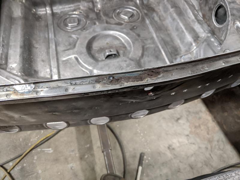

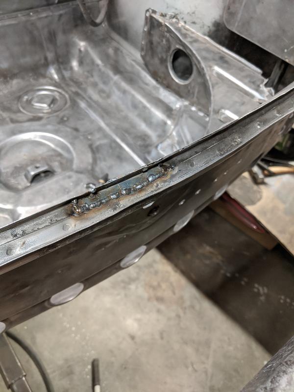

Over the headlight area, this is the side with the fender splice:
(IMG:http://www.914world.com/bbs2/uploads_offsite/i.imgur.com-23821-1588314516.3.jpg)
(IMG:http://www.914world.com/bbs2/uploads_offsite/i.imgur.com-23821-1588314517.4.jpg)
