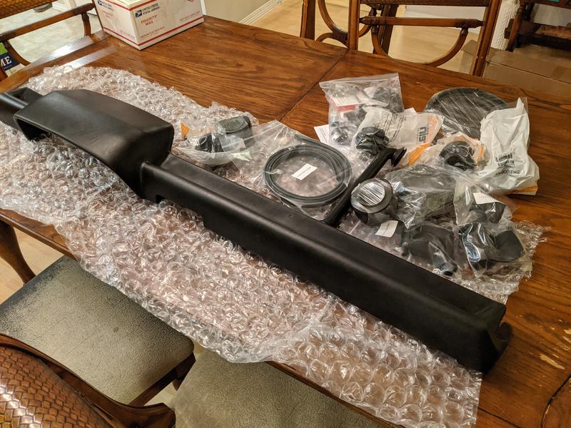

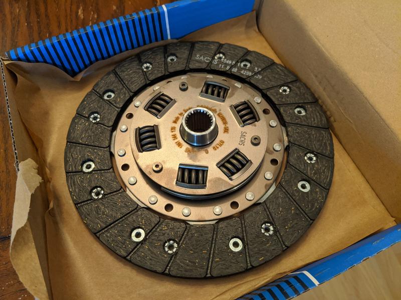

Some new stuff from 914rubber, and a replacement clutch disk (engine was missing the rear seal and soaked the clutch disk with oil).
(IMG:http://www.914world.com/bbs2/uploads_offsite/i.imgur.com-23821-1588314723.1.jpg)
(IMG:http://www.914world.com/bbs2/uploads_offsite/i.imgur.com-23821-1588314724.2.jpg)
