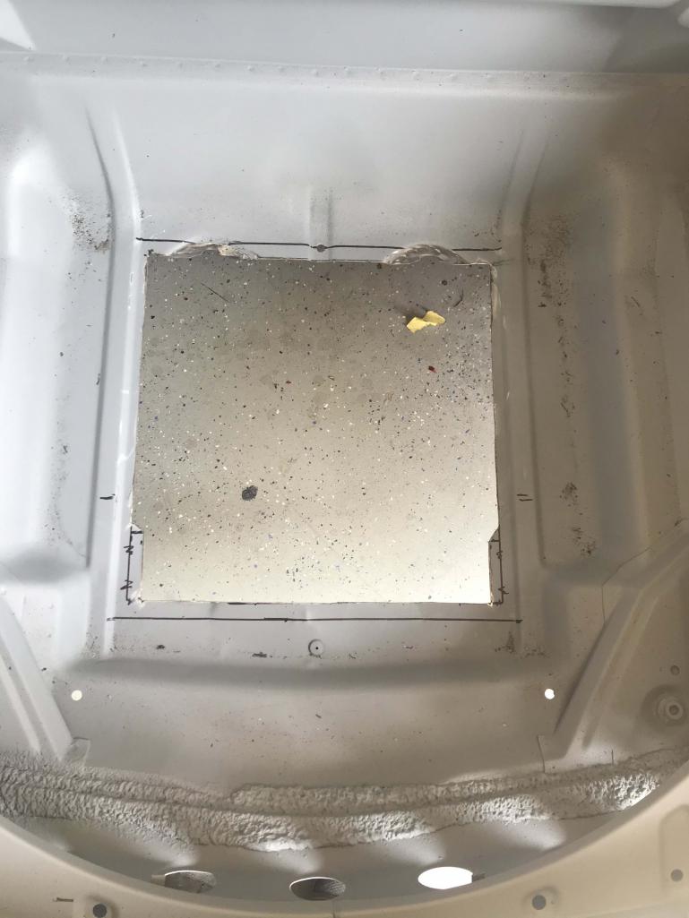

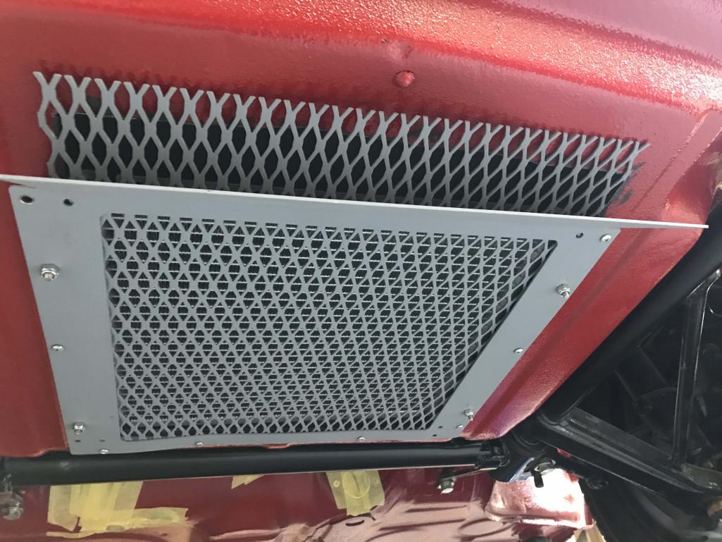

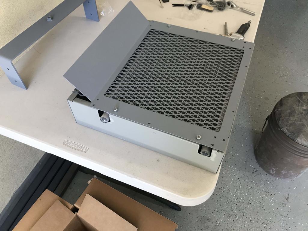

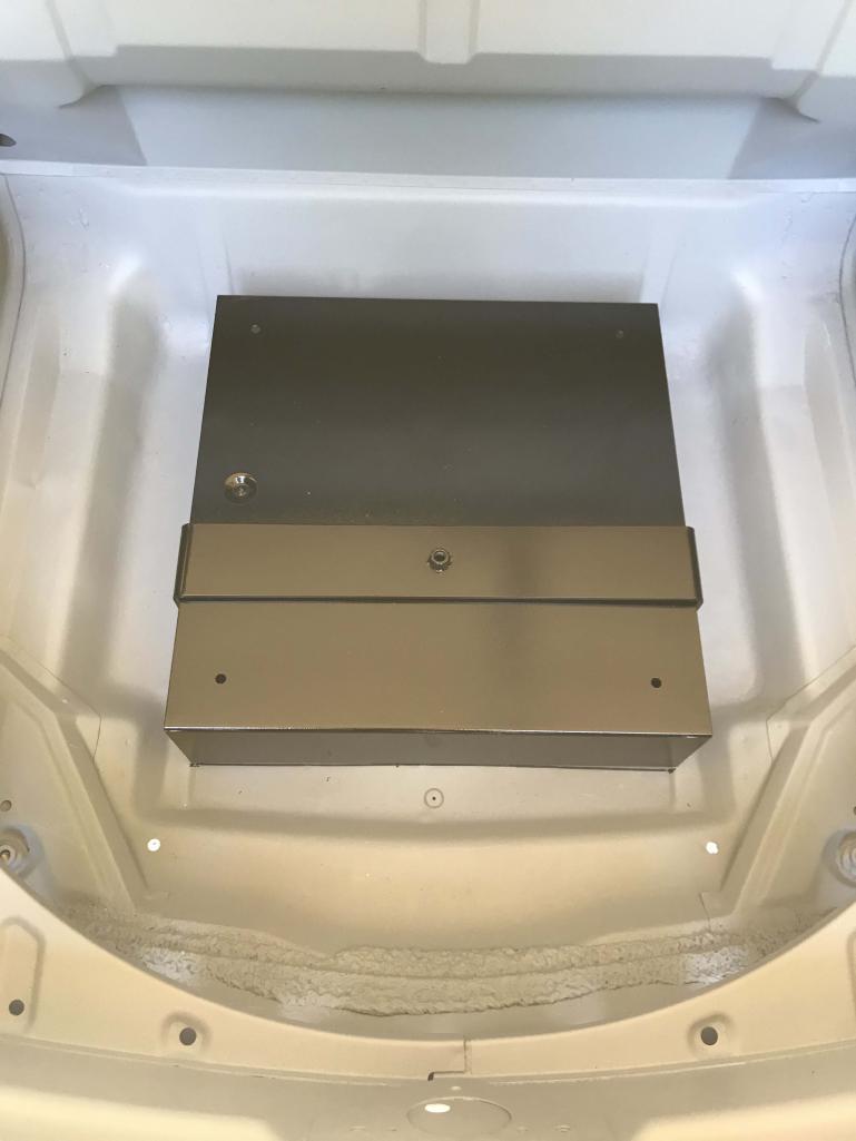

Well, I started the installation process of my A/C on my '74 the other weekend. I went with the Classic Auto Air system. My plan was to just cut the holes needed for the hoses and condenser box prior to painting the [top side of my] car. Here are some photos of the condenser install:

friethmiller   Well, I started the installation process of my A/C...   May 1 2020, 08:53 AM
sfrenck   How close to the ground does the condensor intake ...   May 1 2020, 12:19 PM
