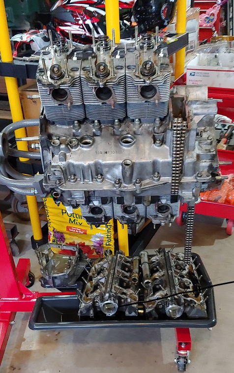

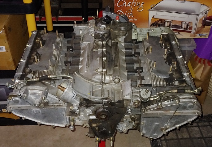

Started the tear down on the 3.2. I'm gonna remove the head studs then split the case.
Supertech head studs are going in so these need to be removed. I hope none of them snap like my brothers 3.0.
3.4 MMS p/c's and a bunch of other parts are on order. It should all be here next week..

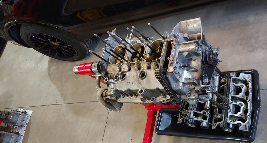

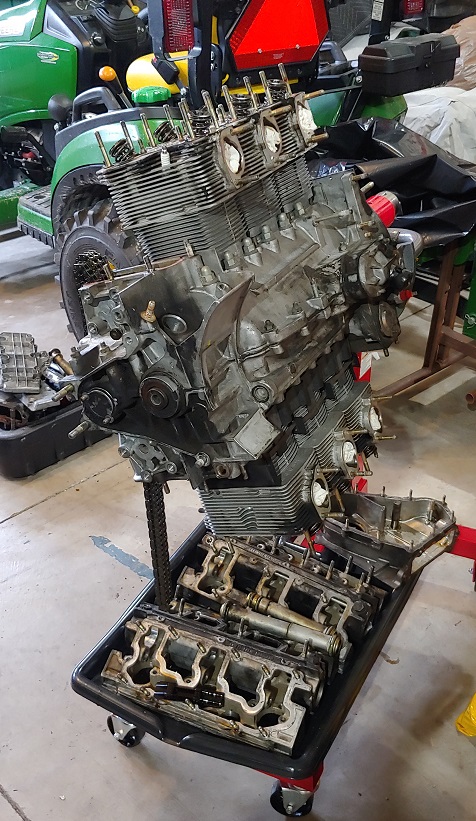

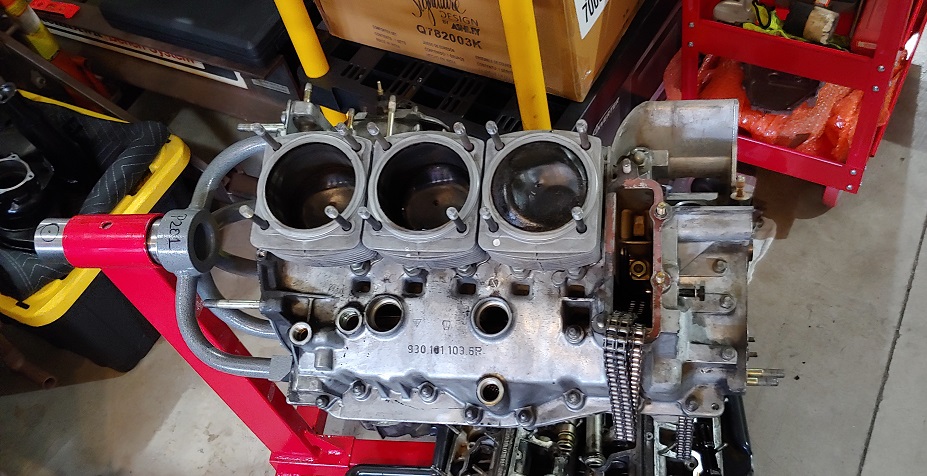

Luke M   Started the tear down on the 3.2. I'm gonna re...   May 1 2020, 09:16 AM
Mark Henry   For the Supertec head studs you'll need a thre...   May 1 2020, 10:49 AM
mepstein   I removed studs from about 25 engine cases when I ...   May 1 2020, 11:31 AM
Luke M   Got the head studs all off without any issues.. G...   May 2 2020, 02:47 PM
Cairo94507   Luke - I am loving that transaxle :wub:   May 2 2020, 04:26 PM
rgalla9146   Looking good Luke Make hay while the sun shine...   May 2 2020, 06:58 PM
Luke M   I split the case today.. Main bearings looked good...   May 3 2020, 01:19 PM
