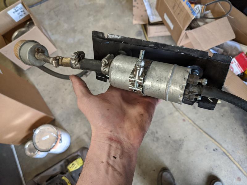

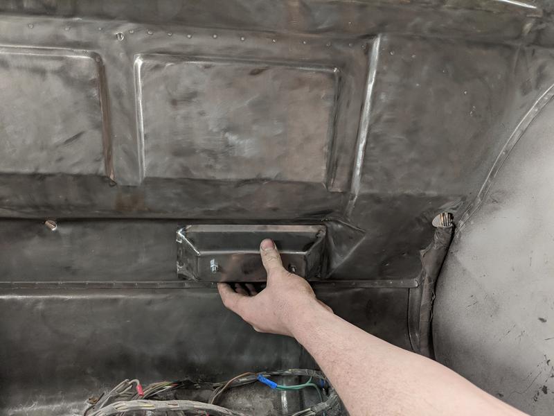

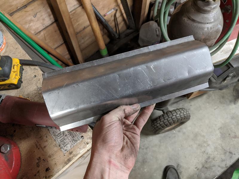

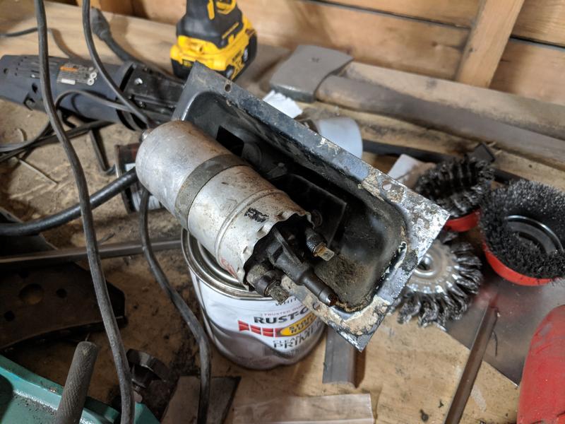

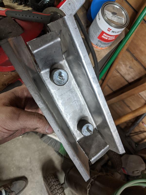

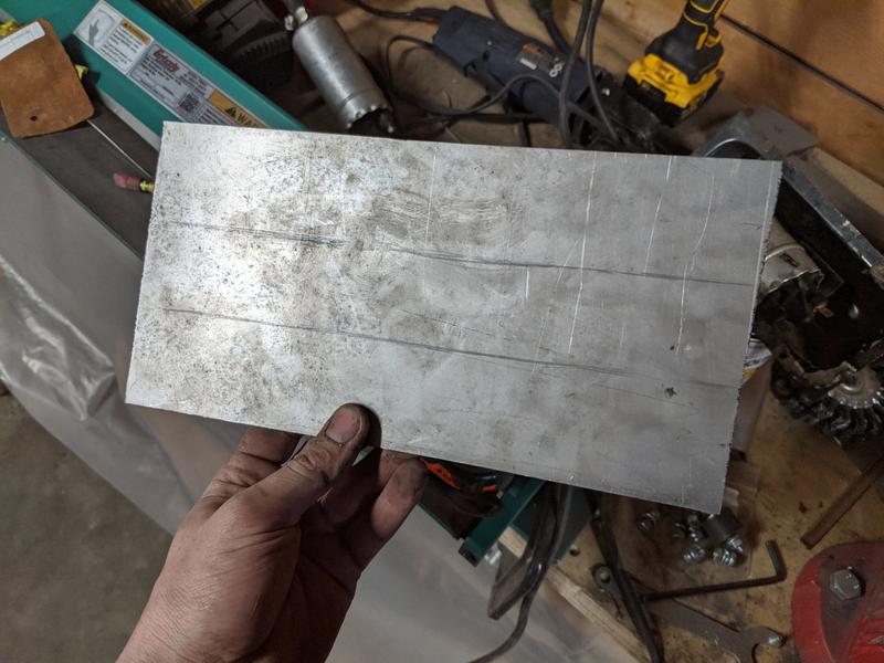

Tried making a front firewall mount to relocate the fuel filter to the front. I had mount from a 1976 car that I sort of copied.
Mount from a later car:
