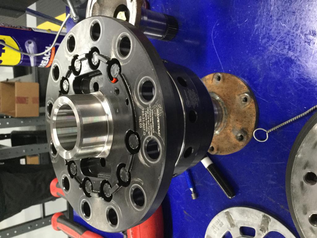

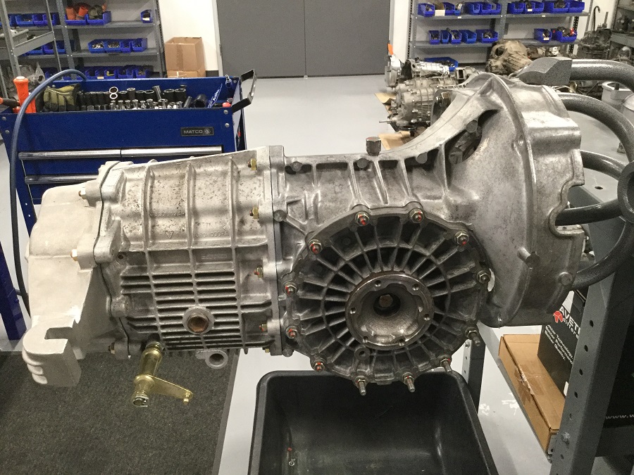

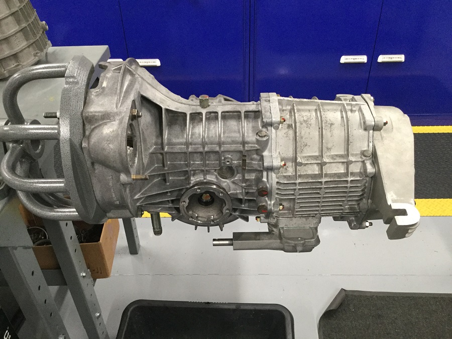

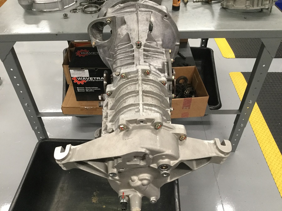

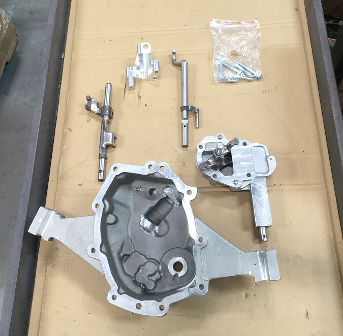

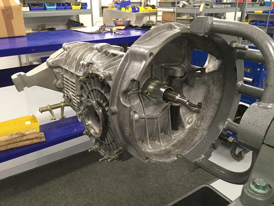

Luke M   I received my converted 915/916 Bott trans back fr...   May 19 2020, 01:35 PM
