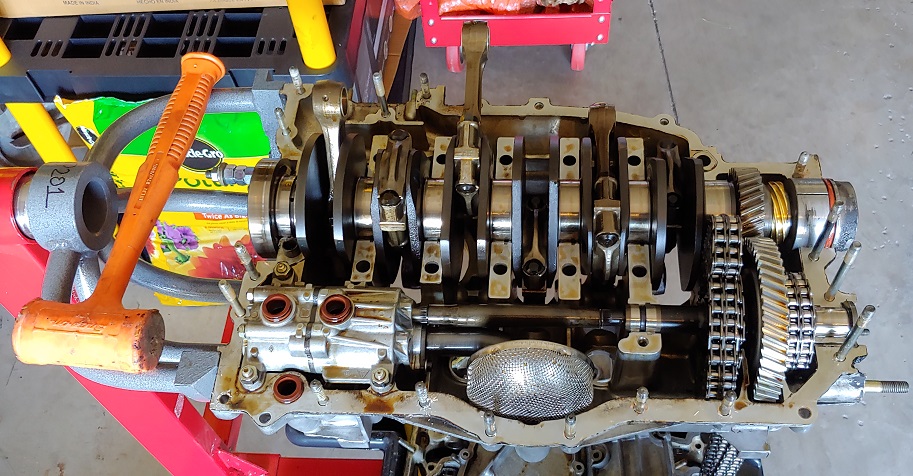

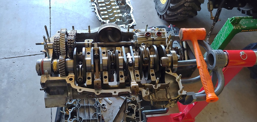

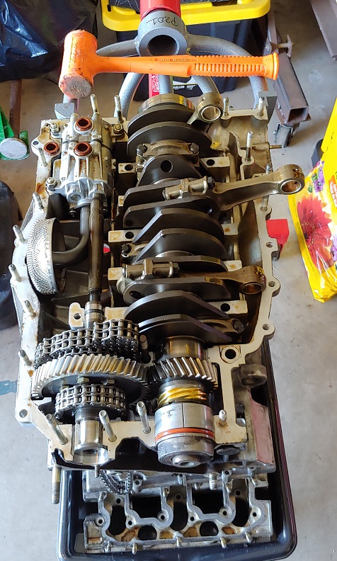

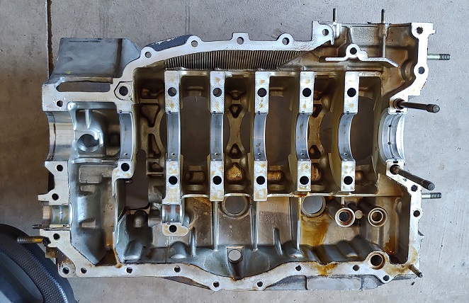

I split the case today.. Main bearings looked good but the lay shaft bearings are showing wear. I need to get the rods removed from the crank then all parts off to the machine shop.
