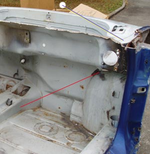

Yes I have cut the windshield off. The windshield and cowl wiegh in at less than 10lbs. There really isn't a lot of material in that area. There are several pieces of material that come together around the door jambs.
Notice the redline is a broken spot weld. You can see through to the fuel tank area. That panel is 1 peice of .050 sheetmetal. No top just an open unreinforced box. There is very little structural intergrity to this area. That is why these chassis twist so bad. The lower A pillar is really strong, not necessarily stiff. It does form a boxed section but the box is vertical and not really tied into the rest of the chassis. The reason it is so strong is because the doors have to hang off them.
The Blue line shows the multiple peices of metal that come togther in the area of the A-pillar, but they just connect like post. Vertical with the rest of the chassis hanging off the post. Very little reinforcement on three sides.

Brett W   It doesn't. What that patch does is, connect ...   Dec 14 2004, 01:18 AM
