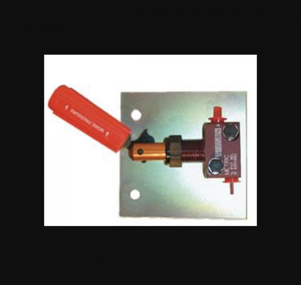

I don’t really like how the pedal is somewhat soft and I have to press the brake quite far to get the desired effect.
I did just find one other thing that I forgot to mention. The PO installed a lever type proportioning valve. I’m not exactly sure how to adjust it. It’s similar to the one pictured. Unfortunately, the handle is not original and there are no markings. Attached thumbnail(s) |

tornik550 What exactly does the lever type proportioning val... May 9 2020, 06:57 PM
