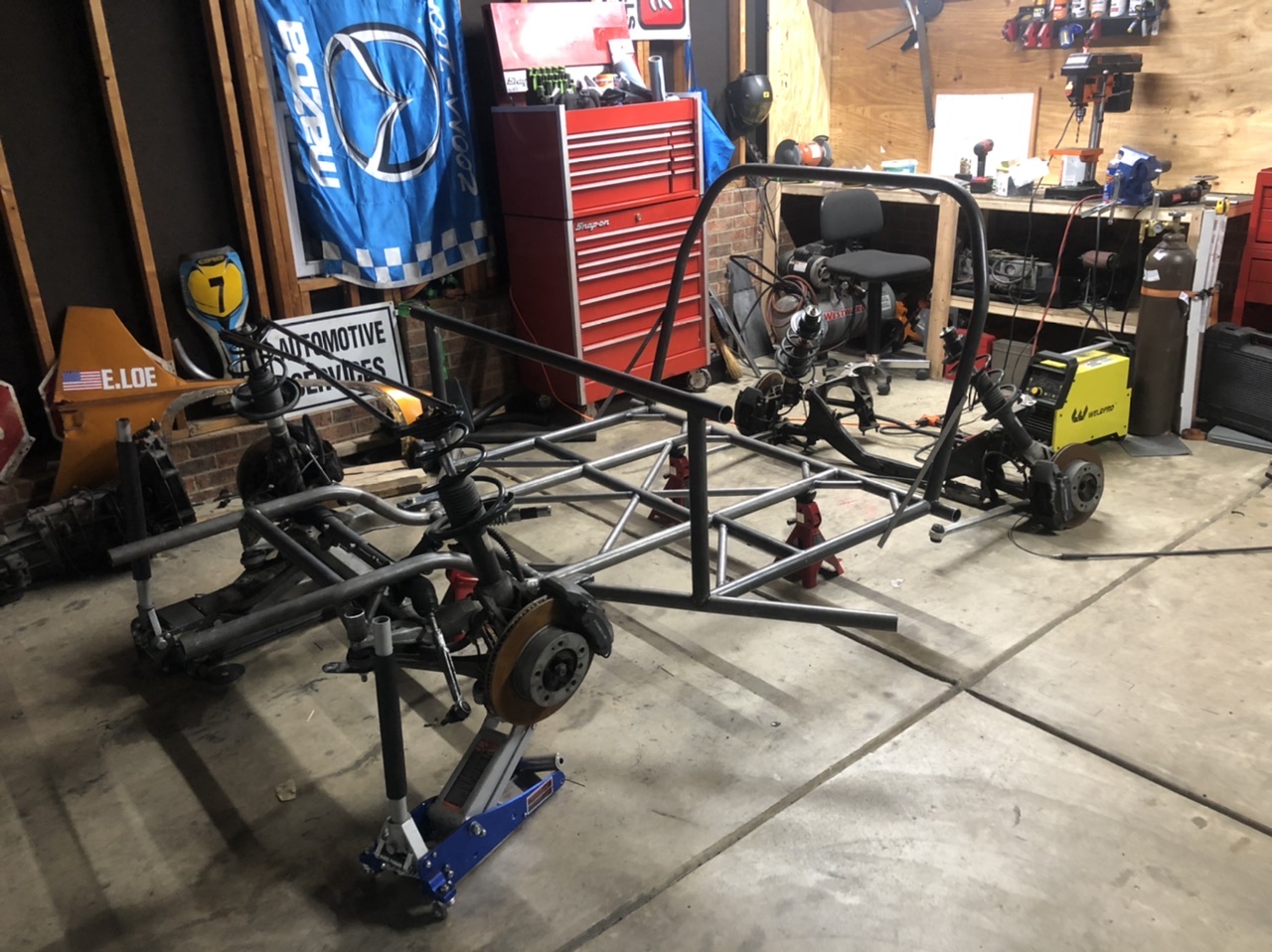

Finally! im done welding up the front subframe in place... for now. It’ll get a little more reinforcement in the future but now i must cleanse myself of the hatred that was welding the front mounts up. Now on to mounting those front struts!

tazz9924   Finally! im done welding up the front subframe...   May 10 2020, 12:44 PM

tazz9924   Its a roller kinda! I added a strut bar on the...   Jun 22 2020, 09:16 PM
