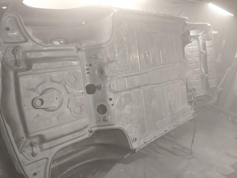

Member ![]() ![]() Group: Members Posts: 89 Joined: 12-January 20 From: SA, TX Member No.: 23,821 Region Association: None |
Been awhile since I posted an update. I stripped everything down as much as I could with wire wheels and abrasive blasted everything else down to bare metal.
Very dusty: (IMG:http://www.914world.com/bbs2/uploads_offsite/i.imgur.com-23821-1589262807.1.jpg) Not the most fun, next time I'll hire this part out: (IMG:http://www.914world.com/bbs2/uploads_offsite/i.imgur.com-23821-1589262807.2.jpg) |
