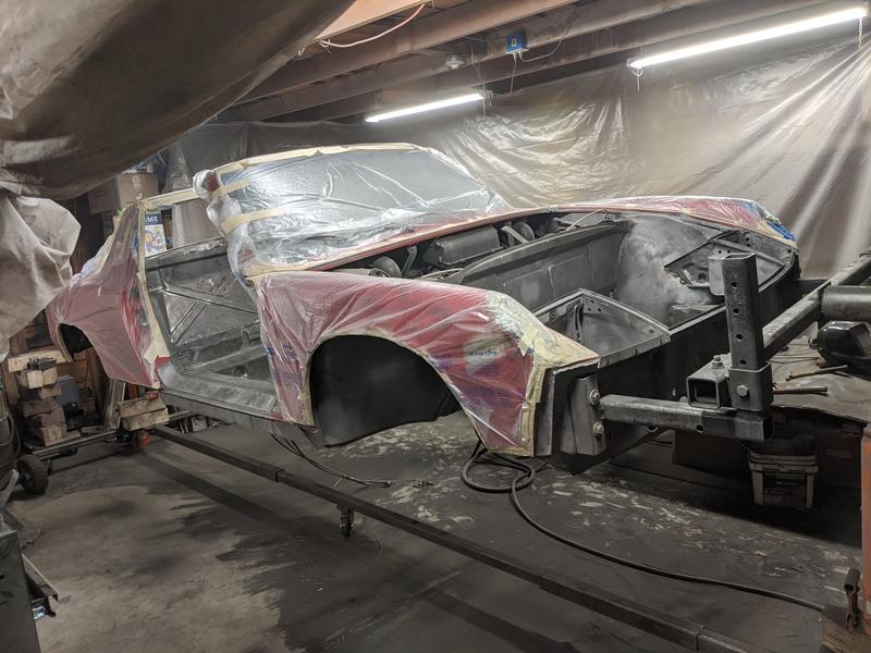

As it sits today:
(IMG:http://www.914world.com/bbs2/uploads_offsite/i.imgur.com-23821-1581113672.2.jpg)

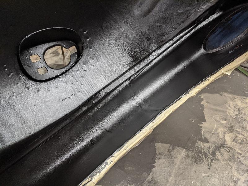

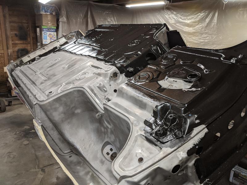

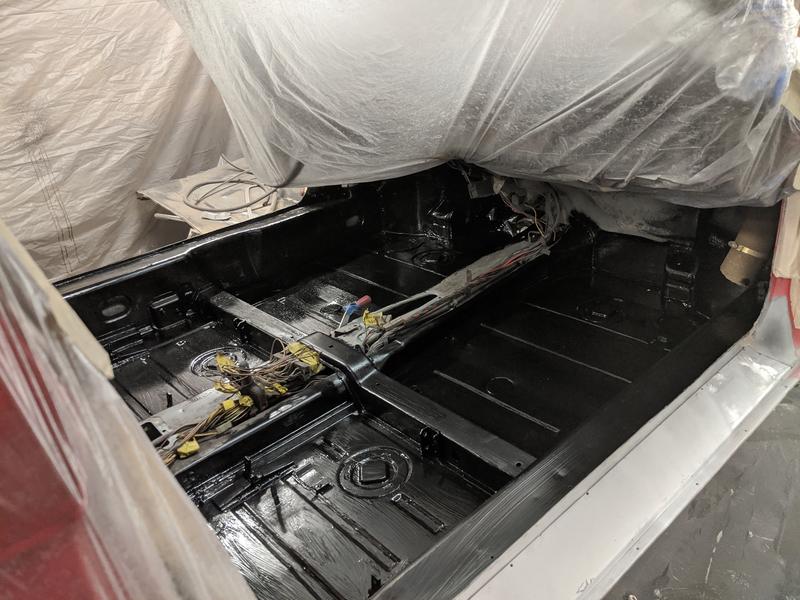

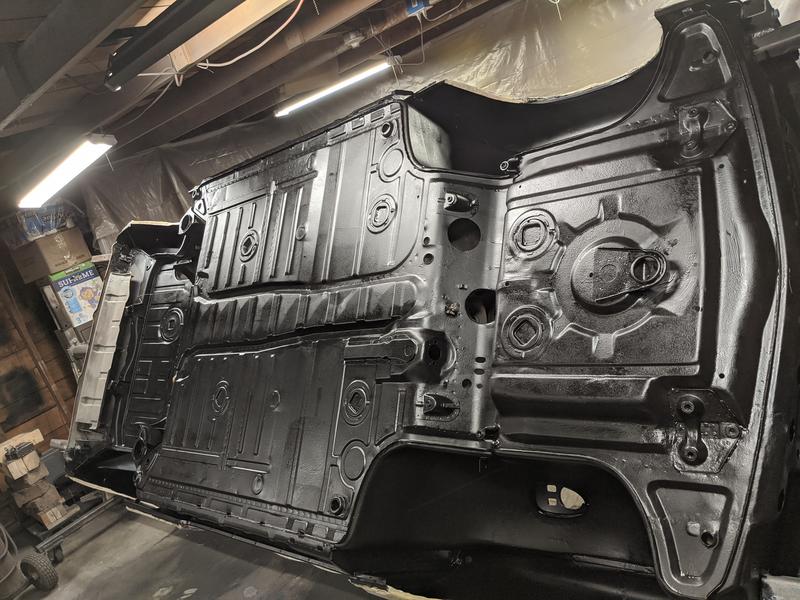

Putting on the epoxy primer. I was going to spray it on, but my shop isn't the best space and I wasn't sure I could get inside the fenders with a spray gun so I used a brush and roller.
Taped off, probably not needed since I'm not spraying:
(IMG:http://www.914world.com/bbs2/uploads_offsite/i.imgur.com-23821-1589263230.1.jpg)
Interior done:
(IMG:http://www.914world.com/bbs2/uploads_offsite/i.imgur.com-23821-1589263231.2.jpg)
Part done:
(IMG:http://www.914world.com/bbs2/uploads_offsite/i.imgur.com-23821-1589263231.3.jpg)
(IMG:http://www.914world.com/bbs2/uploads_offsite/i.imgur.com-23821-1589263593.1.jpg)
The area where the driver's fender was spliced, actually turned out to be fairly well concealed:
(IMG:http://www.914world.com/bbs2/uploads_offsite/i.imgur.com-23821-1589263672.1.jpg)
