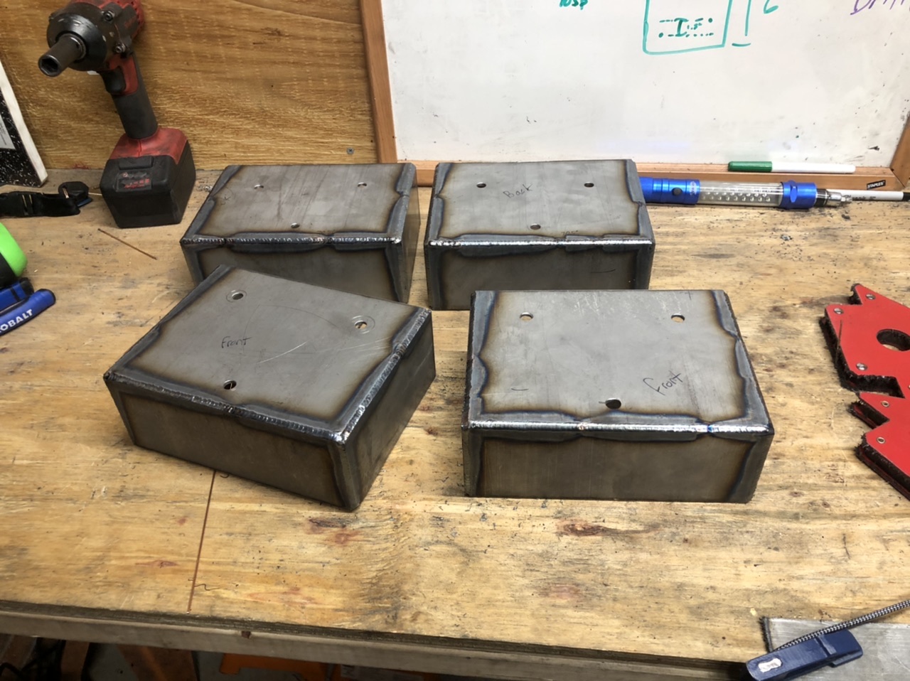

Made my strut tops! Ill be honest i was very excited about making these because i knew they could look good.. and they do! I would’ve preferred to bend the steel instead of having weld joints but i was assured of its strength so ill take it.

914forme   They will be plenty strong as the top plate is tak...   May 14 2020, 05:59 AM
