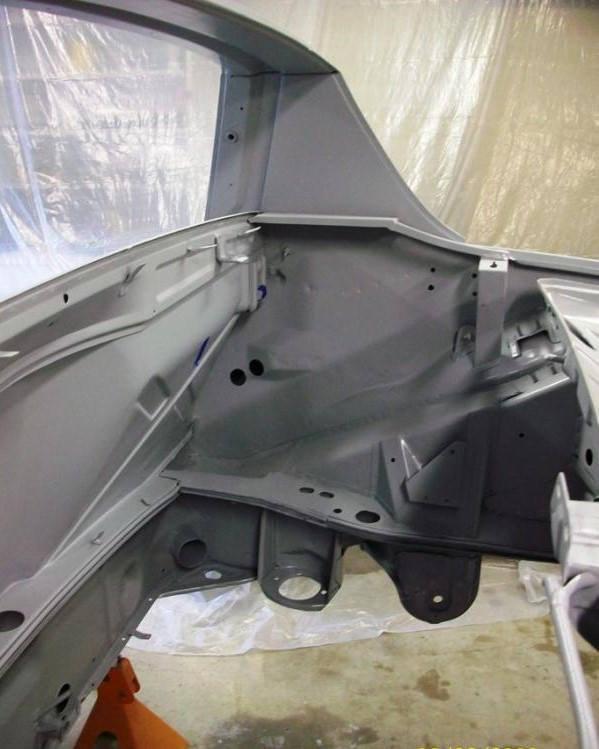

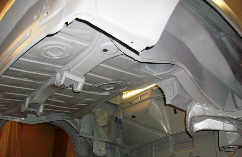

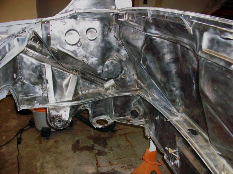

I have done this as well.
Go to HF and buy about 3 grinders for the job if you don't already have them.
Get a couple of the cheap electric drills at HF for this as well.
You'll need an assortment of flap disks with various grits and wire wheels, in sizes and shapes. You'll figure out what works best and choose your favorites. Having 3 grinders and 2 drills will save you significant time as you won't have to change them out each time you want a different removal method. Get an extension of some sort for the wire wheels to get into the corners using the drills.There are a lot of them and they are all hard to access. Don't use air tools or battery powered tools as these will slow you down, and just aren't the tool for the job. Add a large access hole on each side of the battery tray support for access. You may consider removing the tray support to clean up the right long, and replace the support with a new one. Dimple die the holes for strength if you have one. Remove everything now for the best job - Make sure you have a good set of gloves, a respirator and eye goggles. If you don't use these your ability to get the job will be drastically impeded by either the dust in your lungs, eyes, or the pain from your bleeding hands. I'll see if I can find a pic -Attached Image

AWESOME Job...Prep is 95% of the work!!!! (IMG:style_emoticons/default/beerchug.gif)
Paint is easy (IMG:style_emoticons/default/smile.gif)
