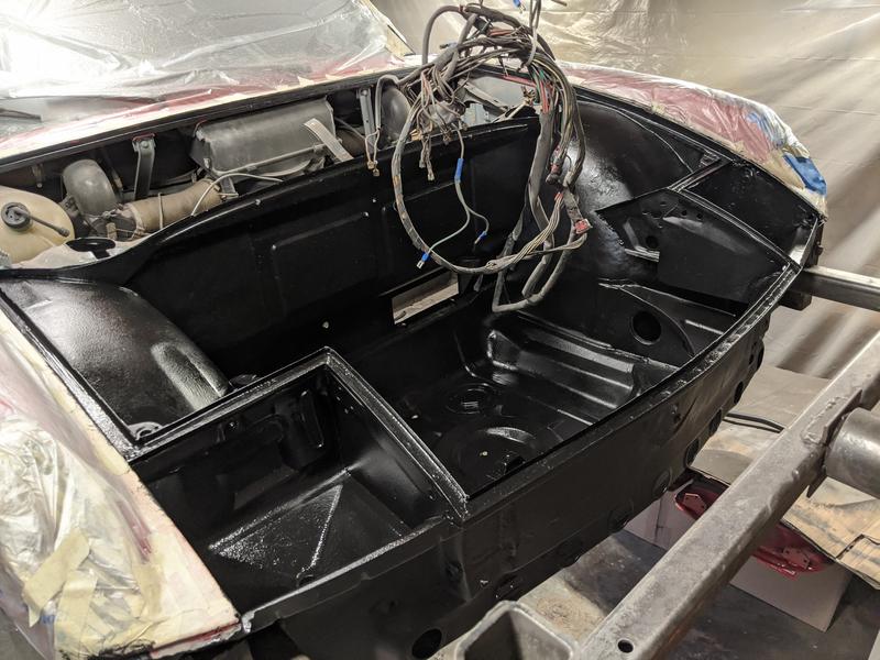

More pictures after epoxy primer
Front trunk:
(IMG:http://www.914world.com/bbs2/uploads_offsite/i.imgur.com-23821-1589492035.1.jpg)

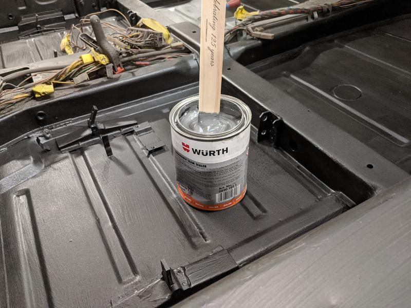

Engine compartment:
(IMG:http://www.914world.com/bbs2/uploads_offsite/i.imgur.com-23821-1589492035.2.jpg)

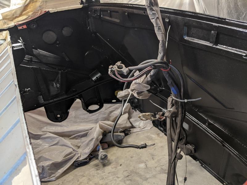

Hell hole area:
(IMG:http://www.914world.com/bbs2/uploads_offsite/i.imgur.com-23821-1589492035.3.jpg)

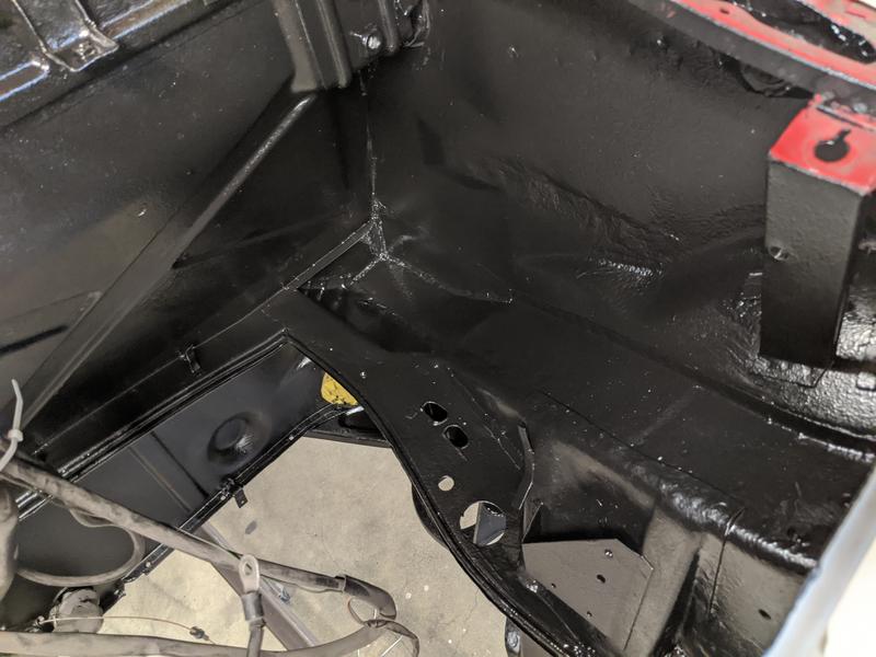

Wurth seam sealer is next:
(IMG:http://www.914world.com/bbs2/uploads_offsite/i.imgur.com-23821-1589492035.4.jpg)
