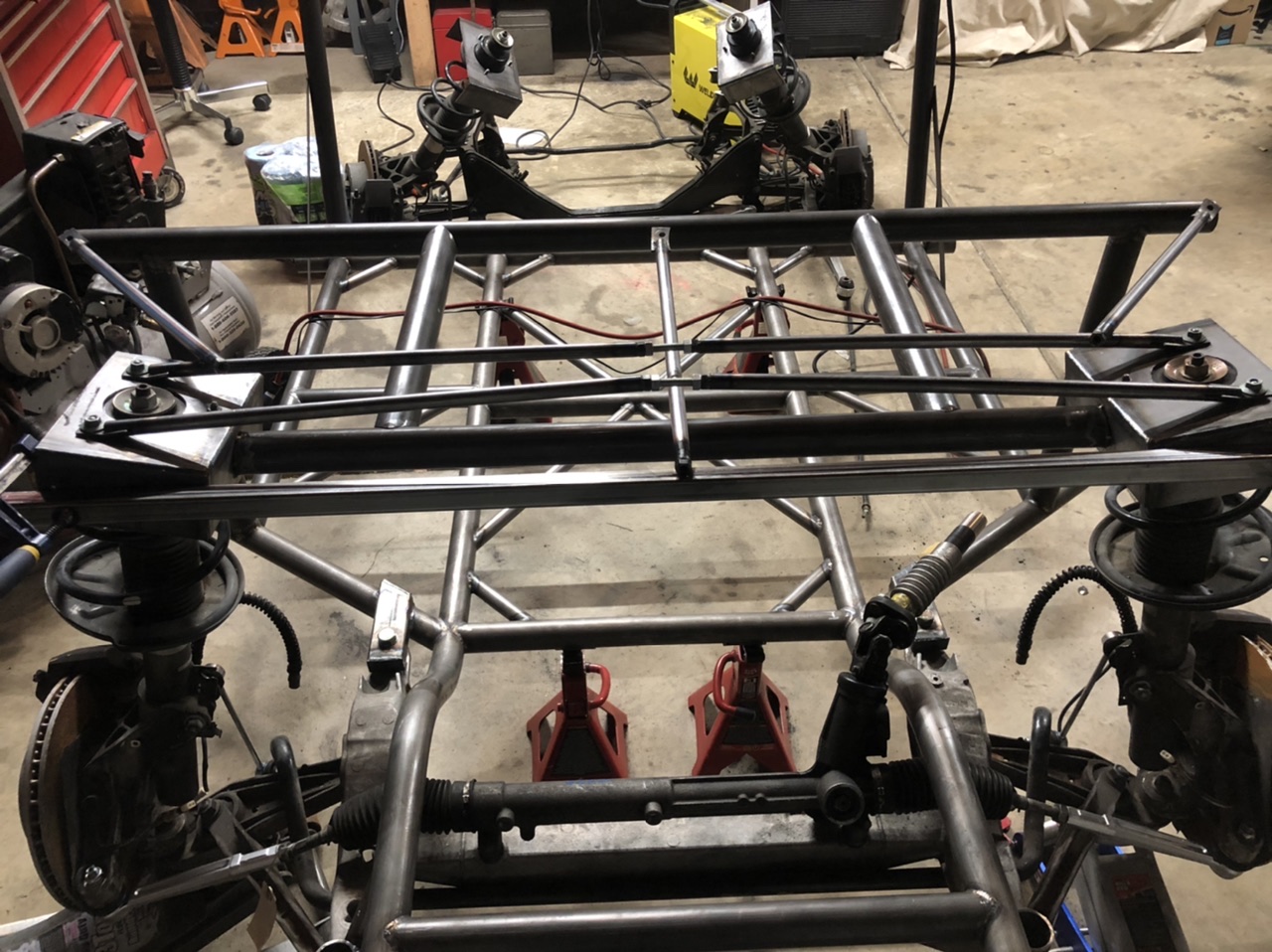

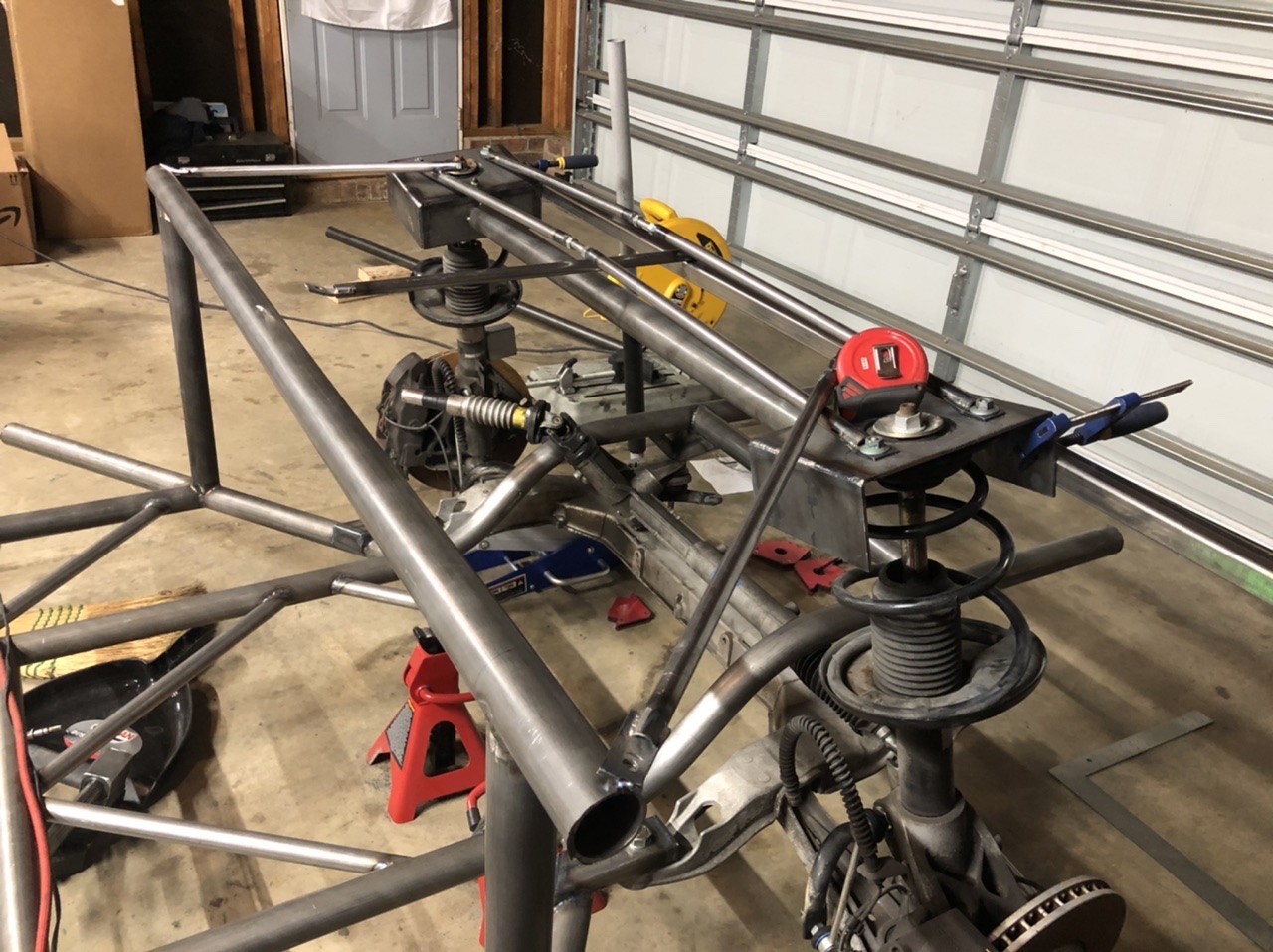

major progress.
I cut the holes in the strut tops to allow for the strut to pass through.
Next i welded in what ill call: The bar that links my struts together and is critical to my camber. I used quite a bit of scaffolding to make sure it was setup right. I used actual measurements from a boxster to space the struts correctly. One of the complaints of the boxster is you cant get enough camber from it stock. I added 1/4” of strut top negative camber. Its not much but i should be able to get a little more out of it if need be. The control arm angle was a point of contention for me. I couldnt find a boxsters control arm angle at full droop, so i... i eye balled it.. intelligently. i know it should be around 1 degree up at ride height, which from what ive read stock ride height is where the strength of this suspension lies. I settled on 20 degrees at full droop. I figure the car will settle an inch when it sets on the ground which will bring it somewhere close to where it should be. This car will have adjustable suspension so i can tune in the control arm angle as needed. It also sets the strut tops fairly low, which is a plus in my book.
Once i finished the; The bar that links my struts together and is critical to my camber bar I then moved onto caster. I matched the caster i measured on a boxster and matched it with two temporary bars. now onto bigger and better things!

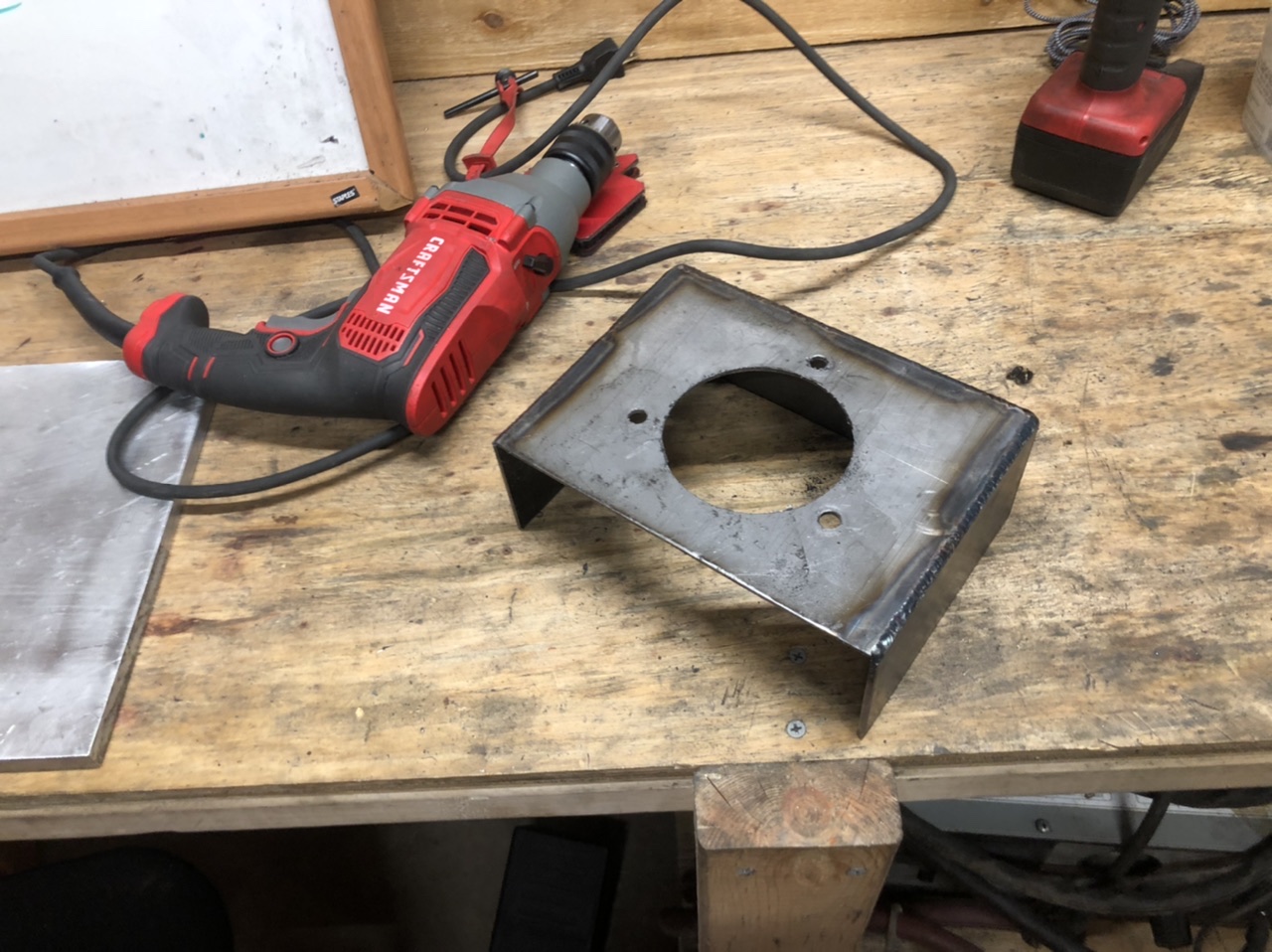

tazz9924   Made my strut tops! Ill be honest i was very e...   May 13 2020, 09:56 PM
914forme   They will be plenty strong as the top plate is tak...   May 14 2020, 05:59 AM
tazz9924   major progress. I cut the holes in the strut tops ...   May 15 2020, 11:45 PM
