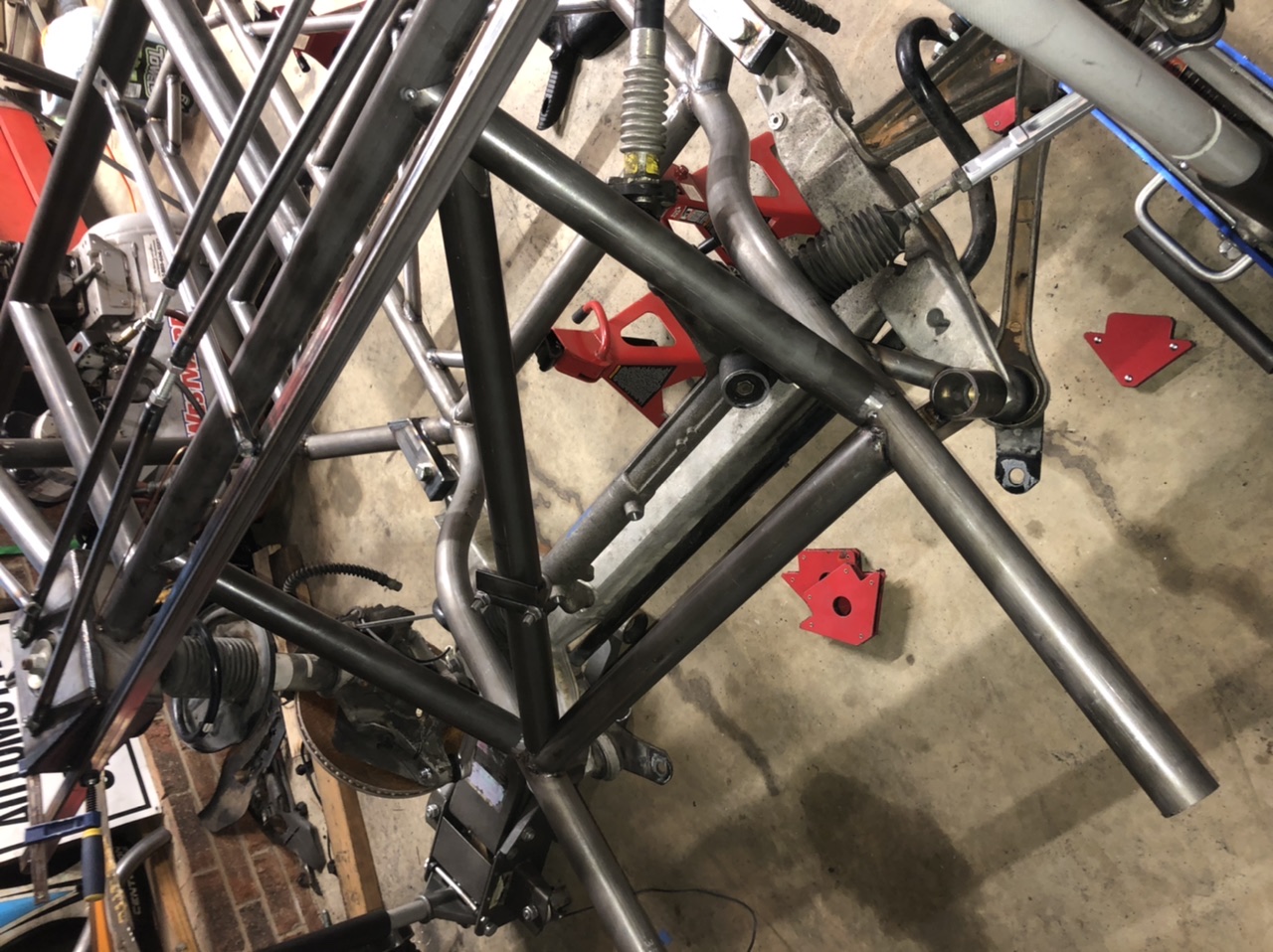

More bars went in today, but not every day goes smooth even when you get in a groove. First i made the bars that go from the dash bar to the struts, easy enough. Some complex angles that aren’t immediately obvious but some flap dish work and its all good.
Next came the bars the go from the main chassis rails to the: The tube critical for my camber and attatching both struts. These bars were a pain! First i tried to link it up with the bar that attatches the two chassis rails. No Beans. 4 try’s down the road i gave up on that pipe dream (get it) and moved them back two inches and bingo! i even got to reuse a mistake bar.
I then attempted to notch up a triangulation bar for the front section but i messed up three times on the same bar. I learned from my mistakes but dang i really wanted to start finish welding (IMG:style_emoticons/default/mad.gif)
I did notice this thing looks like a teenager in that old school head gear, braces things. Do people still get those?

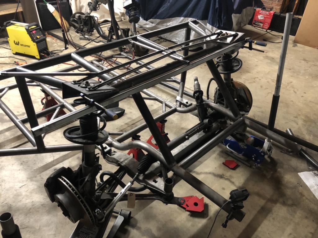

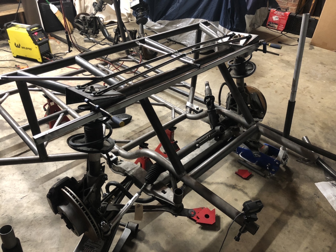

tazz9924   Finally! im done welding up the front subframe...   May 10 2020, 12:44 PM
tazz9924   Made my strut tops! Ill be honest i was very e...   May 13 2020, 09:56 PM
914forme   They will be plenty strong as the top plate is tak...   May 14 2020, 05:59 AM
tazz9924   major progress. I cut the holes in the strut tops ...   May 15 2020, 11:45 PM

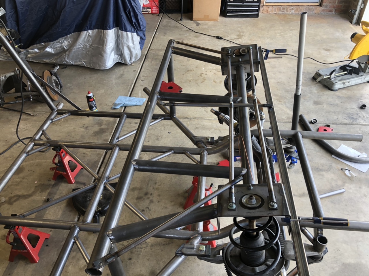

tazz9924   More bars went in today, but not every day goes sm...   May 17 2020, 09:44 PM
