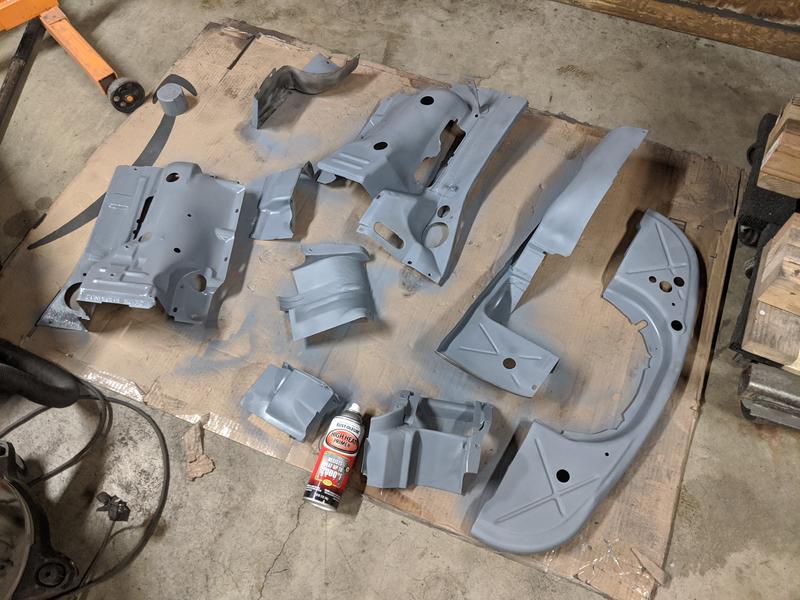

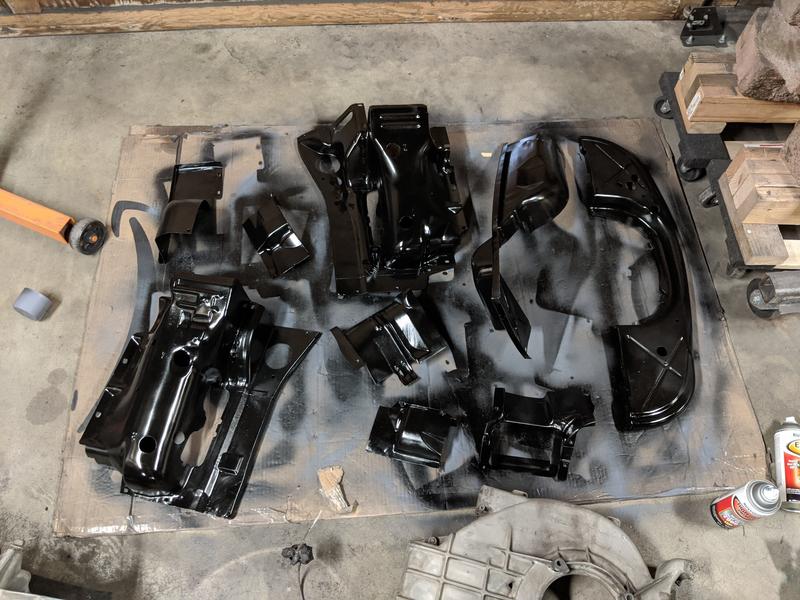

This car is moving from Washington to Texas in 2 days, doesn't leave me much time to get it trailer ready!
Quickly abrasive blasted and painted the engine tin with high temp paint:
(IMG:http://www.914world.com/bbs2/uploads_offsite/i.imgur.com-23821-1589833639.1.jpg)
(IMG:http://www.914world.com/bbs2/uploads_offsite/i.imgur.com-23821-1589833639.2.jpg)
