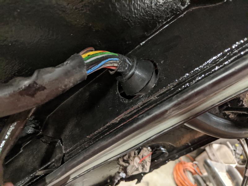

I put a new rubber snorkel from 914rubber on, doesn't fit at the top though (hole in engine shelf is too big). I have an idea on how to fix it, but it's odd that the website says that it fits all years?
(IMG:http://www.914world.com/bbs2/uploads_offsite/i.imgur.com-23821-1589833721.1.jpg)
