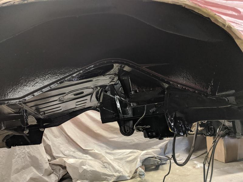

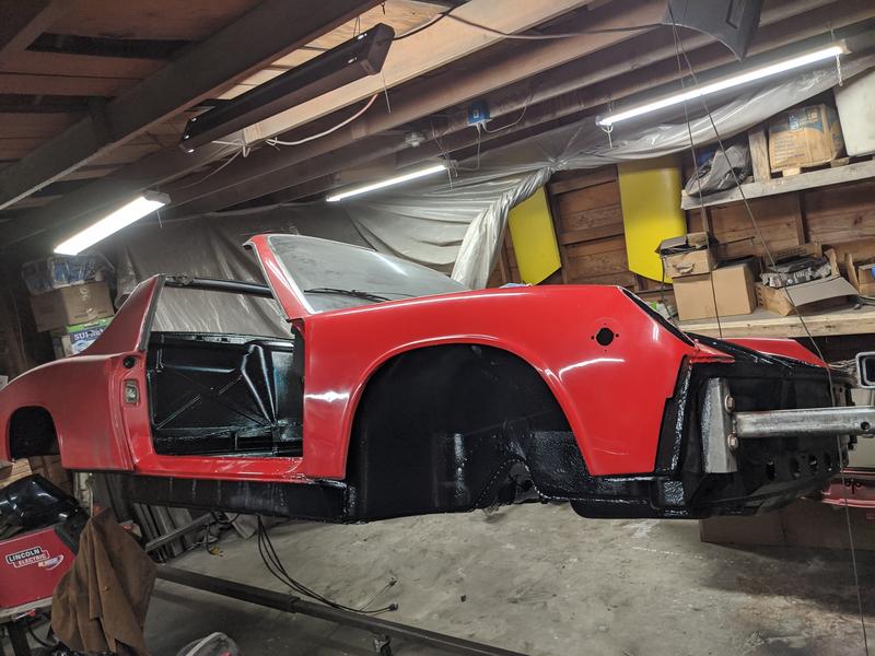

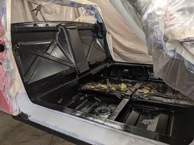

sreyemj   Been awhile since I posted an update. I stripped e...   May 11 2020, 11:53 PM
sreyemj   Putting on the epoxy primer. I was going to spray...   May 12 2020, 12:00 AM
sreyemj   More pictures after epoxy primer Front trunk: htt...   May 14 2020, 03:33 PM
