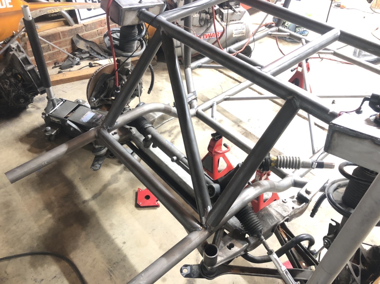

tazz9924   Ok update: I was out of town for a couple days and...   Apr 19 2020, 07:50 PM

jd74914   What's this holding? If it's seeing any...   Apr 29 2020, 09:39 AM
Andyrew   Welds look nice! BTDT on the greyhound in th...   Apr 29 2020, 01:27 AM
tazz9924   Welds look nice! BTDT on the greyhound in t...   Apr 29 2020, 05:55 AM

bkrantz   I get dizzy looking at the tubing angles in front ...   Jun 21 2020, 09:37 PM
tazz9924   I get dizzy looking at the tubing angles in front...   Jun 22 2020, 12:13 PM
