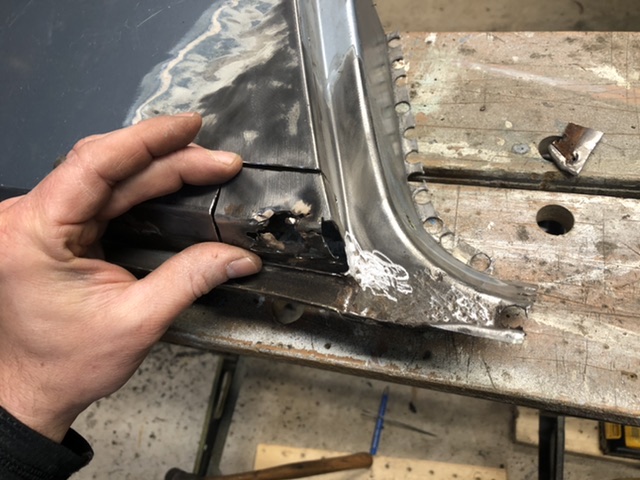

Pulled my rocker covers today to inspect for rot. Unfortunately I found significant rust on both jack points and the driver’s side long has a good size rust hole. I’m going to cut and patch the bad spots in the longs, but I’m trying to avoid a complete resto right now and I don’t want to get into exterior bodywork. The rear fenders are in pretty good shape but they seem to block access to the top flange of the jack point plate. Does anyone know if the jack points can be replaced correctly without cutting out a lower portion of the rear fender?

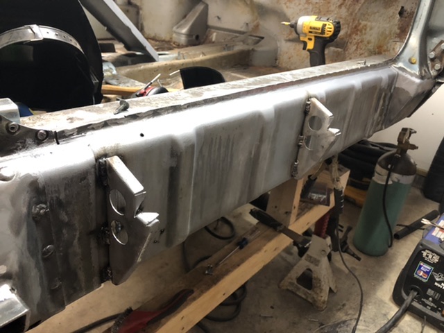

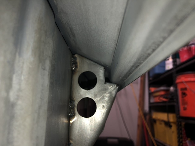

Got the sill triangles installed today. Had the same fitment issue with the threshold sills and the sill triangles that bbrock did. Thanks to his well-documented posts, I modified my sill triangles in the same fashion.

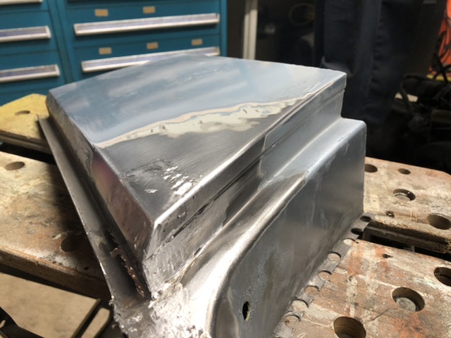

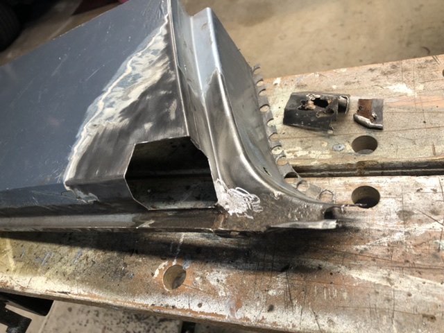

Also discovered a small rust hole hiding beneath some bondo in the section of rear fender that I cut out for access to the jack points. Figured it would be easier to fix this now before I reinstalled this section on the car.

IronHillRestorations   You'll probably have to cut a section off the ...   Mar 10 2020, 04:44 PM
dlee6204   It is possible to replace the points without cutti...   Mar 10 2020, 05:38 PM
flyer86d   I’ve done it by cutting out the lower couple of ...   Mar 10 2020, 05:59 PM
Superhawk996   Uh, what what do you intend to weld to? Can’t w...   Mar 10 2020, 07:07 PM
bbrock   Yeah.... I'm afraid you are beyond being able ...   Mar 10 2020, 07:13 PM
cary   Yes you can. But you can only do 3 rosettes on the...   Mar 11 2020, 08:45 AM
