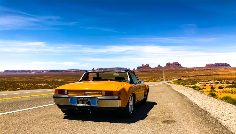

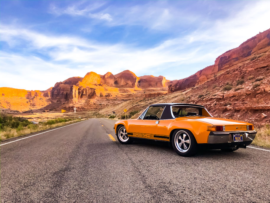

A huge thanks to Eric and Sam and the team at PMB for making this happen.
Thanks also for all of the kind words about the car!
As far as the question with the fiberglass hood and stock latch mechanism. I drove it at high speeds through heavy winds and had zero issues, of course the fitment on this is everything, I can imagine if the hood did not fit well it could catch some air and have an issue.
It’s was a great adventure to drive this thing 1500 miles across the Southwest. I highly recommend a long drive in these cars.
