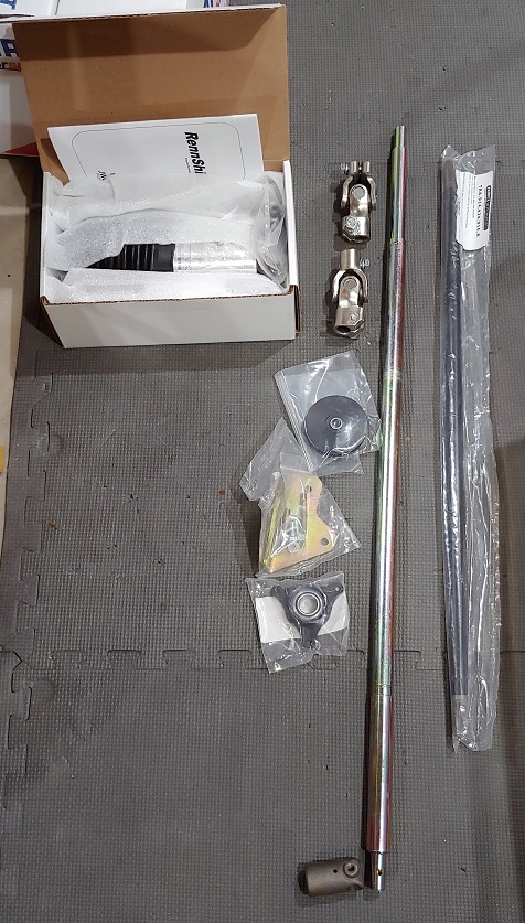

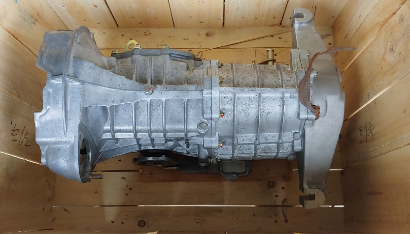

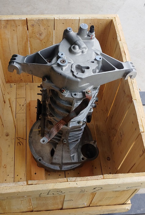

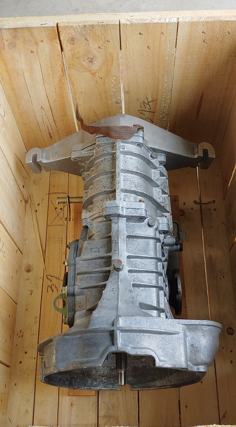

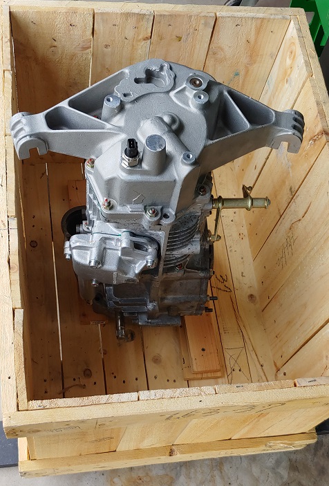

I received my converted 915/916 Bott trans back from PMS today.
I also purchased the PMS shift linkage kit to work with the new setup.
