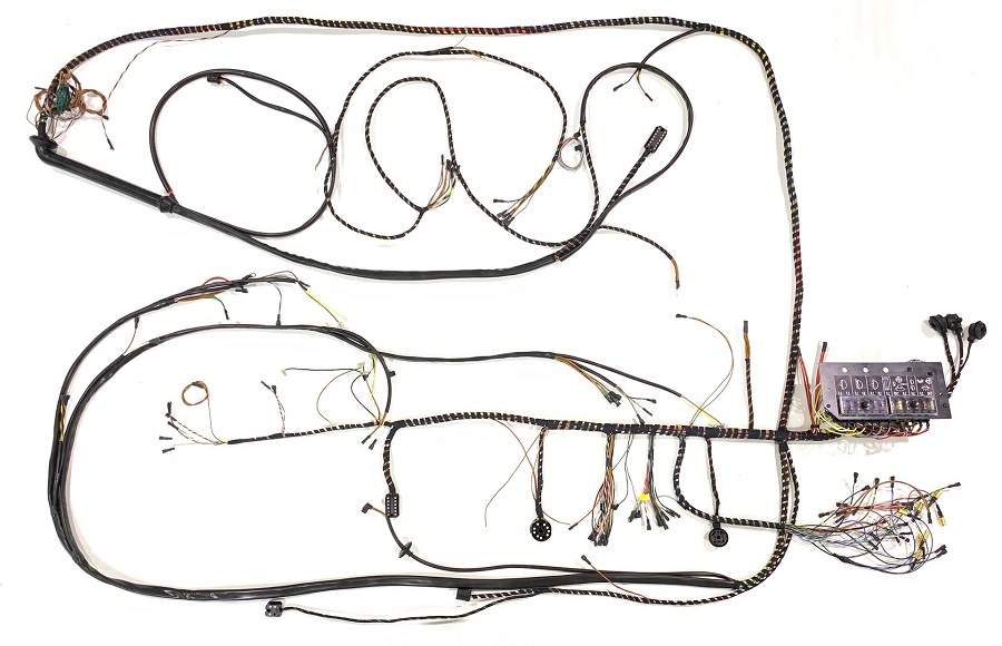

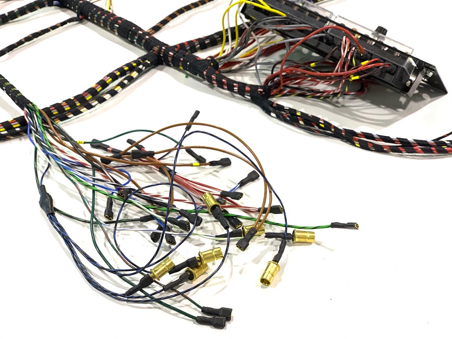

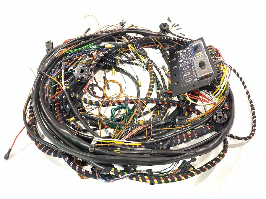

Well it has been awhile since I updated this..
Change of plans on the chassis jig. I purchased a frame bench form Perry and I will use that to fix the chassis. I've been collecting more chassis parts along the way so hopefully once I start cutting it will make the re assembly a little faster.
Kroon wire harness co. sent me an email that my new chassis harness is done and ready to be shipped. I should see that in about two weeks. Gerard sent me a few pic of it so enjoy. (IMG:style_emoticons/default/drooley.gif)
