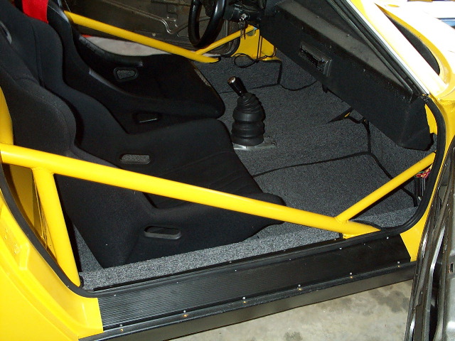

Rather than attaching your top, consider some tubing.
I put this stuff in my car to help it handle a big engine, it's not for safety. The increase in stiffness is nothing short of amazing. The tubing continues, uninterrupted to the front and rear.
Let me know if you'd like to see more.

Bigbohr   Just wondering how much reinforcing the rails woul...   Dec 14 2004, 07:50 PM
Series9   Rather than attaching your top, consider some tubi...   Dec 14 2004, 08:43 PM
Bigbohr   If that goes into the front trunk and the engine c...   Dec 14 2004, 09:23 PM
Series9   This is the best one I have right now (I'm on ...   Dec 14 2004, 10:07 PM
Series9   engine bay:   Dec 14 2004, 10:10 PM
Series9   rear:   Dec 14 2004, 10:11 PM
