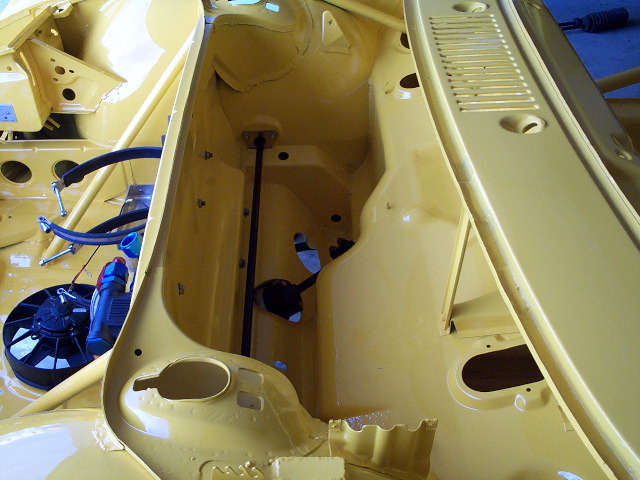

This is the best one I have right now (I'm on the road).
If you look carefully at the bottom of the picture, just behind the trunk spring mount, you can see the welded mount for the 1" tubing coming from under the dash. If you look across you can see the opposite tube going to its mount. If you look in the front, you'll see the two 1" tubes residing in that space.
All the tubing in this car is straight in order to keep rigidity to an absolute maximum.
I can take additional pictures when I get home later this week. I have good pictures of the engine bay and rear trunk.

Series9   Rather than attaching your top, consider some tubi...   Dec 14 2004, 08:43 PM
Bigbohr   If that goes into the front trunk and the engine c...   Dec 14 2004, 09:23 PM
Series9   This is the best one I have right now (I'm on ...   Dec 14 2004, 10:07 PM
Series9   engine bay:   Dec 14 2004, 10:10 PM
Series9   rear:   Dec 14 2004, 10:11 PM
