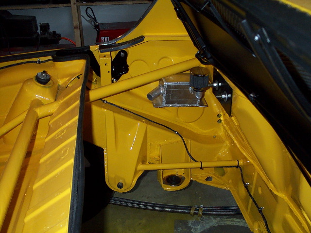

Series9   Rather than attaching your top, consider some tubi...   Dec 14 2004, 08:43 PM
Bigbohr   If that goes into the front trunk and the engine c...   Dec 14 2004, 09:23 PM
Series9   This is the best one I have right now (I'm on ...   Dec 14 2004, 10:07 PM
Series9   engine bay:   Dec 14 2004, 10:10 PM
Series9   rear:   Dec 14 2004, 10:11 PM
