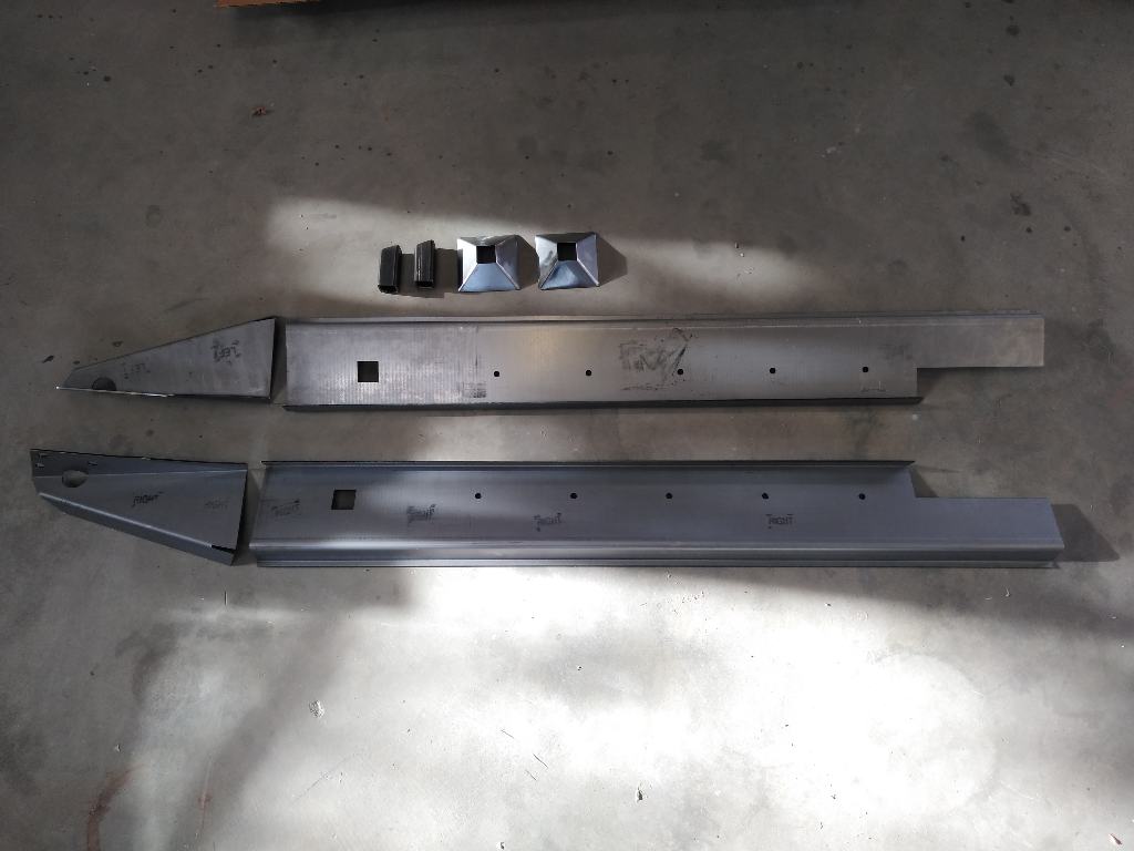

Been a crazy last few weeks with work and projects around the house. Found a few hours here and there to (mostly) finish the a/c install. But before we get to that I had these arrive recently:
I am hoping they are the answer to my door gap nightmare.
If interested you can look here for some background http://www.914world.com/bbs2/index.php?sho...=326911&hl=

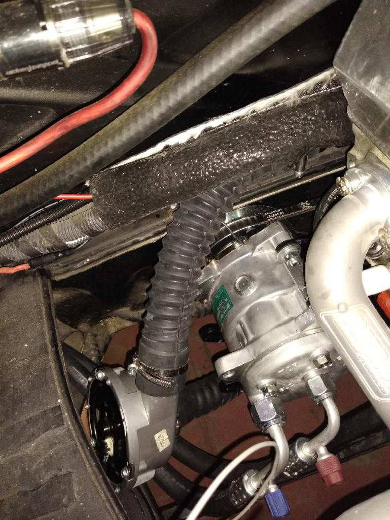

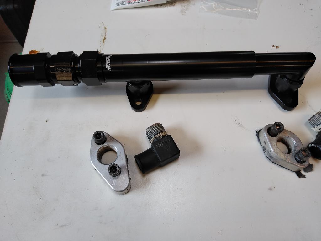

Ok back to the a/c. I decided to go a different route with the engine coolant lines. I had been running the Renegade setup which was fine, but I found some AN fittings that looked like they would cleanup the install. The pic below shows the old (bottom) to new setup.
It was a pricey detour, and the verdict is still out if it was a good decision. It did clean up the install, so as long as leaks don't develop I should be good. The new pipe was running on top of the main wire harness, so I ran a thermal blanket around the wire to protect it.

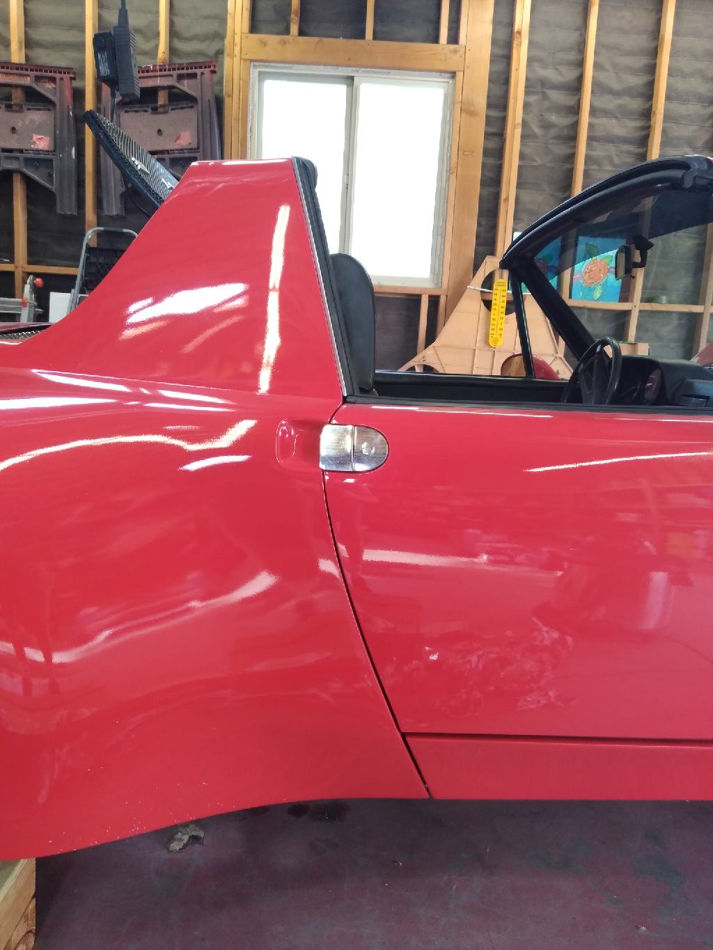

FL 000   Next up got the car on supports to adjust the door...   Sep 6 2020, 01:55 PM
76-914   Insert some wood shims from inside between the doo...   Sep 6 2020, 02:21 PM
914forme   You will always get a bit of shrinkage when you we...   Sep 6 2020, 05:57 PM
