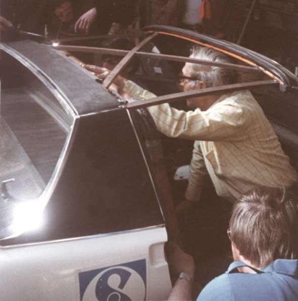

you could always follow what they did on some of the GTs ...
here's the lufthansa GT ...

SirAndy   you could always follow what they did on some of t...   Dec 14 2004, 11:42 PM
