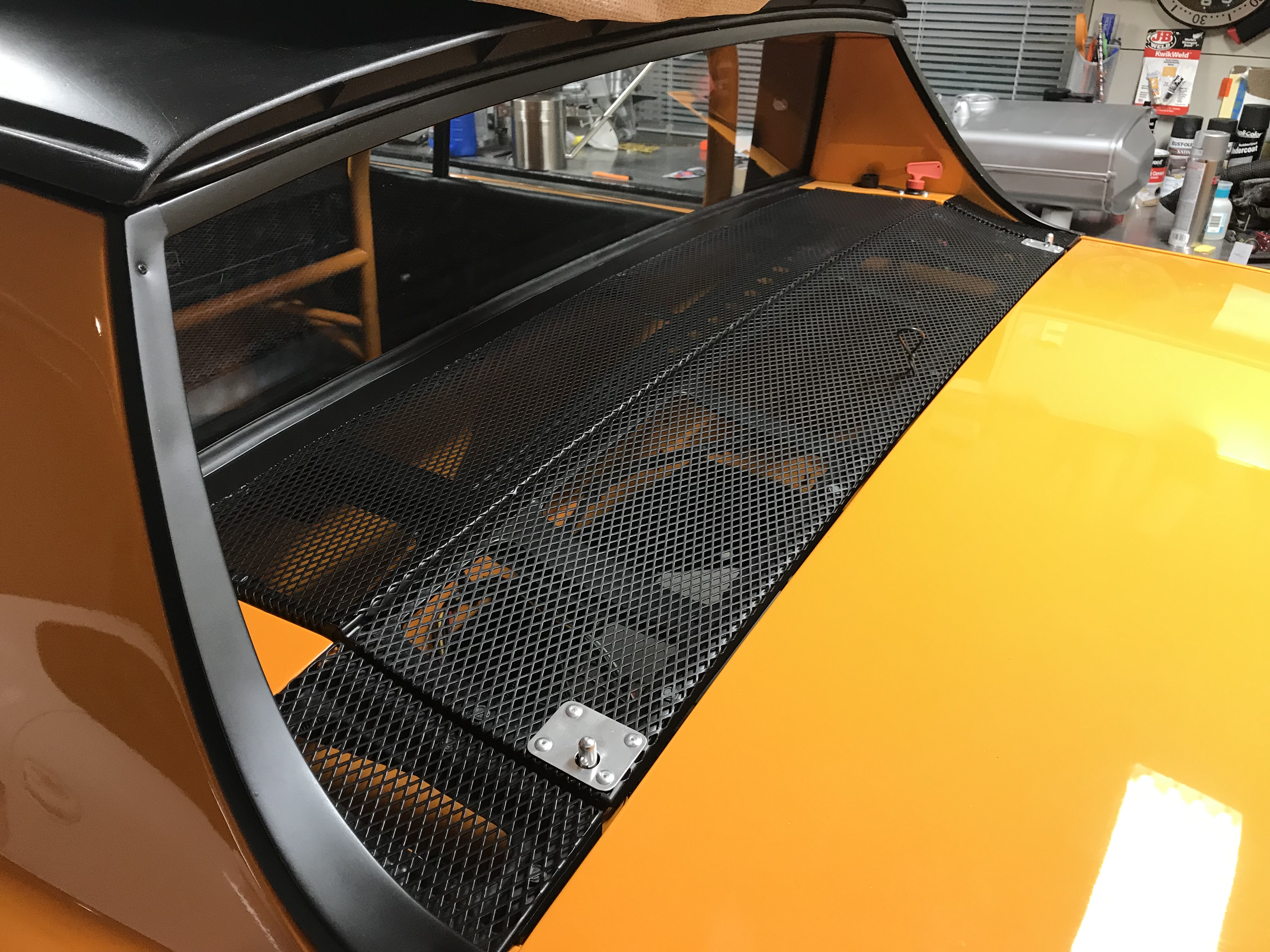

mlindner
post May 23 2020, 05:05 AM
Posts: 1,803
Joined: 11-November 11
From: Merrimac, WI
Member No.: 13,770
Final product just great. MarkAttached Image

mlindner   Thanks Eric for the post. My buddy came up to Wisc...   Nov 25 2019, 06:29 AM
mlindner   Final product just great. Mark   May 23 2020, 05:05 AM
Eric_Shea   Great job guys! :trophy:   May 27 2020, 03:14 PM
windforfun   A true artista!   May 27 2020, 05:12 PM
SO.O.C914er   Nice work! :welder: If someone has one ready ...   May 27 2020, 07:07 PM
dangrouche   Nice work! :welder: If someone has one ready...   May 28 2020, 09:54 PM
mlindner   Nice work! :welder: If someone has one read...   May 29 2020, 10:39 AM
